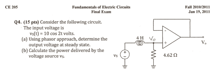

Opamp Circuit: Finding Voltage at Resistor and Power Supplied
In summary: But the voltage and current were in phase, so the power supplied is positive. Read the problem carefully and see what it is asking for.
brk51
29
V_- = V_+
There is negative feed back so V- =V+ ... Vout is then equal to the voltage at the positive terminal
So the solution does a voltage divider... finding the voltage at the 4.62 ohm resistor..
However I did KCL at Vo...i1 = i2(i1 being the current going into the positive terminal and i2 being the current flowing down towards the resistor) ====> ((Vo - 10<0)/ j8) = Vo/4.62 ...my final answer for Vo was 5<60 or 2.5 +j4.33..where did I go wrong?

Your node equation is not correct. On the left side you have the current flowing from the node through the inductor to the source, and on the right you have the current flowing from the node through the resistor. They can't both be flowing out if they are on opposite sides of the equation, since that leaves nothing flowing into the node. You're bound to end up with a sign error.
The way to avoid this sort of slip is to always write all the terms on one side of the equation and set the other side to zero. Choose one direction for the current terms, either all treated as flowing into the node or all flowing out of the node. The math will take care of itself.
So if we take what you've already done and write it as a sum of currents flowing out of the node we have:
##\frac{Vo - 10∠0}{j8} + \frac{Vo}{4.62} = 0##
Gotcha! So correct answer for Vo should be 5<-60.. then for the second part..finding the power supplied by the Vs --- (10<0 - Vo)/(j8) = I1
Power supplied by source = ((-V * I)/2) cos(thetav - thetai) --- the negative sign because it's supplying (think I might have this wrong..) and divided by two because these are not RMS values...>>>> thetav = 0 theta i = -60..thus cos(60) >>> so ((10)*(1.082))/2) * cos(60) = 2.7 W or -2.7 W ??

I would just write ## V_R=V_s (R/(R+j \omega L)) ##. This one is very straightforward. It's an op-amp buffer circuit and no current flows through(i.e. across the infinite input impedance of) the ideal op-amp.

The voltage across the resistor is in phase with the current. There is no power loss in the inductor. You just need to compute ## P=V_R^2/(2R) ##. (The factor 2 in the denominator to make it r.m.s. of ## V_R^2 ##.) You could also take the r.m.s. voltage out of the source multiplied by the r.m.s. current and multiplied by the cosine of the phase angle, but the first method is quicker. They should give the same result in both cases. ## \\ ## I think my arithmetic is correct, and it agrees with your answer that ## P=2.7 ## W.
Gracias... last question.. if it is asking for power supplied..does that mean the 2.7 W is negative? How do you know when to make it negative?

Very rarely will power go into the source. When that occurs, the power supplied is negative. I think if the phase angle between the voltage and current had been in the 2nd or 3rd quadrant, the power supplied would be negative.
