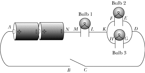

A circuit is made of two 1.5 volt batteries and three light bulbs as shown in Figure 19.57. When the switch is closed and the bulbs are glowing, bulb 1 has a resistance of 9 ohms, bulb 2 has a resistance of 44 ohms, bulb 3 has a resistance of 28 ohms, and the copper connecting wires have negligible resistance. You can also neglect the internal resistance of the batteries.
Picture Attached of Circuit
2. (a) With the switch open, indicate the approximate surface charge on the circuit diagram. Which of the following statements about the circuit (with the switch open) are true:
1. The electric field in the filament of bulb 3 is zero.
2. There is a large gradient of surface charge between locations M and L.
3. The surface charge on the wire at location B is positive.
4. The electric field in the air between locations B and C is zero.
5. There is no excess charge on the surface of the wire at location C.
I chose 2, 3, and 4. This is not the correct combination of answers. 1 should be wrong because there is current flowing through the filament, E can't be xero in the bulb. I figured 2 was correct because the wire would have a large negative gradient as current leaves the negative end of the battery. I thought 3 would be correct due to it being on the side of the circuit closest to the + end of the battery, and I picked 4 because I thought the charges on either side of the switch would cancel each other out. There is a negative excess surface charge at C, so 5 is incorrect.

I thought 1 was 0 because current isn't traveling past the switch since its open, and I assumed 2 was 3 because this the same as the delta V leaving the battery.

Try and ignore all the traps making you do parts a) b) and c) first.
Lets go for 2d, because it will give you a testbed on which to try out the options. We can do them later.
Take a few general principles. While the switch is open, there is no current. No electrons are flowing. It is true that when the circuit was constructed, some electrons flowed briefly to put a charge in all the bits, but then it stopped. If you ever manage to put a voltage across a bulb resistance, there will be a current through it. So - with no current, what would you expect if you tried to measure a voltage across a bulb?
If you have learned to figure series and parallel resistances, work out the total resistance in the circuit.
If you cannot, then post here what you think is the way to calculate the total of 2 resistances in parallel.
If you are OK so far, then use the voltage in the circuit, and the total resistance you just found, to find the main current in the circuit if you close the switch (I3).
I3 is divided into some that goes through bulbs (2) and (3) unequally, but you can get to it by knowing that the thing they have in common is the voltage across them. So press on. Now you know the current, use it to also find the voltages dropped across the resistances.
By now, you are getting to know quite a lot. You now have the means to apply the very same law to figure I1 and I2. if you get stuck, then post here your attempt.
Once we have this part untangled, we can better see how do do the other bits. You may find it starts to occur to you.
