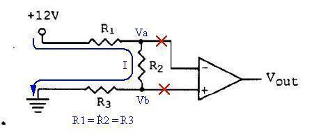

The resistors can be treated as being in series.
You have that right. :smile:
However, your formula for Vout makes no sense to me.
An operational amplifier has a different formula for Vout.
It's Vout = (V+ - V-) AOL.
Where the "open-loop gain" AOL is typically about 10000.
Furthermore Vout can not be higher or lower than the voltage applied to the operational amplifier (in your problem that is given as +15 V respectively -15 V, but this is not drawn in your diagram).
Can you tell me what the voltages at the + and at the - of the operational amplifier are?
+15
-15

Noooooooo.
Did you really think it would be that simple? :rolleyes:
Here's the full schematic of an operational amplifier
In your case Vs+ is +15 V and Vs- is -15 V.
These form the power supply of the operational amplifier.
You have yet to determine V+ and V-, before you can calculate Vout.
You should do that for instance with KVL through the resistors...
You should assume that no current is drawn by the operational amplifier (other than from its power supply).

Suppose for a moment that you cut the wires to the op-amp inputs. You're left with a voltage divider consisting of three equal-values resistors connected to 12V at one end and ground at the other. Call the nodes where the resistors connect Va and Vb. You should be able to tell by inspection whether Va will be greater than, less than, or equal to Vb.
You can even say that the amount by which Va and Vb differ doesn't matter! ANY difference in voltage between the op-amp inputs will drive the op-amp output to either the positive supply level or the negative supply level, depending upon whether Va > Vb or Va < Vb.
Yes, no current ever flows into (or out of) an ideal op-amp's input leads. So the only path for current to flow is through the external resistors.
*Necromantic bump!*
Just for verification, the answer here is "true, the output is -15 volts since V- > V+"
