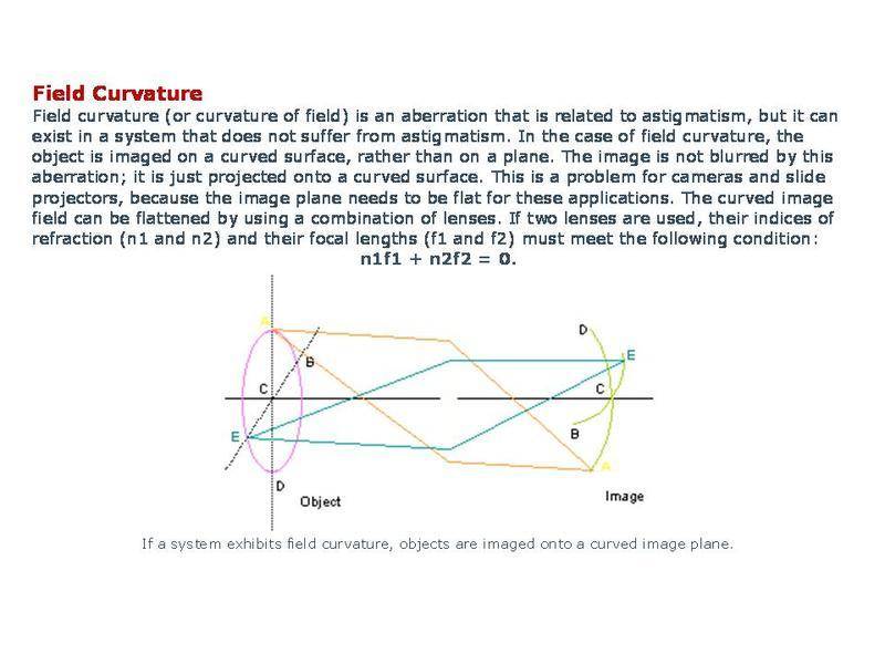

I keep seeing this equation pop up and I have no idea what it is or where it comes from.
[tex]n_{1}f_{1}= -n_{2}f_{2}[/tex]
It looks like a take on snell's law, but what assumptions have to be made to get to this equation from snell's?

The formula is related to an optical aberration called field curvature. See attachment.
Thank you.
