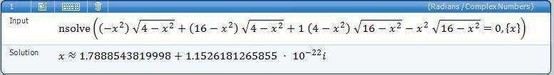

My last simplified was this=-x^2sqrt(4-x^2)+(16-x^2)*sqrt(4-x^2)+1(4-x^2)*sqrt(16-x^2)-x^2*sqrt(16-x^2)
Once I know the value of x, I can solve the 2nd part (b) by my self.
Thats what I get when I shove the last line into some software. So I am guessing that you have went wrong somewhere... Unfotunately its too late at night for me to think clearly. This is just a heads up.

Your expression for dA/dx looks fine, but I think you went wrong when you tried to simplify it.
[tex]dA/dx = -x^2 (16 - x^2)^{-1/2} + (16 - x^2)^{1/2} - x^2 (4 - x^2)^{-1/2} + (4 - x^2)^{1/2}[/tex]
From the first two expressions, pull out a factor of (16 - x^2)^(-1/2). From the last two expressions, pull out a factor of (4 - x^2)^(-1/2). You should get
[tex]dA/dx = (16 - x^2)^{-1/2}(-x^2 + 16 - x^2) + (4 - x^2)^{-1/2}(-x^2 + 4 - x^2)[/tex]
[tex]= \frac{16 - 2x^2}{\sqrt{16 - x^2}} + \frac{4 - 2x^2}{\sqrt{4 - x^2}}[/tex]
Set this last expression to zero and solve for x.
