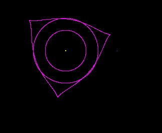

tony873004, thanks for that. Initially I was wondering how useful that specific simulation would be since the orbit of the third planet was not at the angle I wanted with the second and fourth planet. I wanted it to start so that with respect to the outer planet's orbit, the third planet would trace close to a triangle with the fourth planet in the middle of the base. Like this:

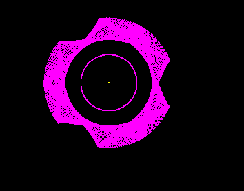

But your simulation started with that triangle tilted, like so:

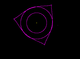

But as I watched the simulation, I noticed that the orbit of the third planet changed, and the "triangle" traced by the third planet rotated until it was exactly where I wanted it to start:

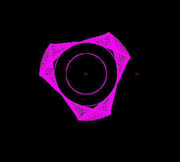

Then began oscillating back and forth around that point. So that shows me that for this simulation at least, that orbit would seem to be very stable. After a thousand orbits or so, the orbits look exactly the same and this is the path the third planet has traced out with respect to the fourth. To me, this suggests pretty good orbital stability.
