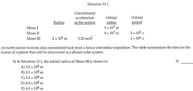

I come up with a solution that is much smaller than any of the choices. I do not know if I am to assume the orbital is circular. I do not know if there is another error besides that in my work.

Hello,
You need not assume that the orbit is circular. Use one of Kepler's Laws (which applies for both circular and elliptical orbits).
ok if I use kepler's third law would I start by using moon II orbital period and radius to solve for the mass of the planet?
You don't need to solve for the planet's mass. Remember that R^3 is proportional to T^2, and that must hold for all objects orbiting a body. Hence R^3/T^2 = constant.
ok so I can find that ratio from moon II data and then multiply that ratio by T^2 of moon III?
yup, that is right
thank you for your help
