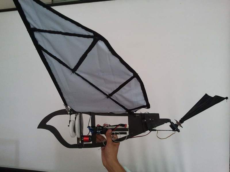

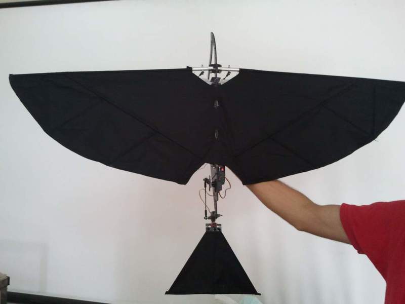

i have designed and fabricated an ornithopter with flapping frequency of 4Hz and span of 1m... Actuation of wings is perfectly fine but it is unable to generate lift...what are the possible amendments should i do to make it fly...and it is a bit over weight i-e 700g...

Tie it to helium balloons.
Its too heavy and the thing itself looks to big to generate lift without flexion of the wings
But i am not an expert on unsteady low RE flight
I'm no expert either, but I agree, the biggest problem is probably weight. But a close second is the wing dynamics. You're probably getting just as much downward thrust on the wing upstroke as you are in the downstroke. Any way you can allow/induce more flexion in the wings on the upstroke?
You could probably easily do this just inserting a second joint about 1/3 down the way. Take a look at some photographs of birds that are a similar dimension. Also, what airfoil are you using?

i am using parachute cloth without any airfoil.

Yes, you are right weight is the biggest issue but i am unable to reduce the weight. As in the wings, i am using the parachute cloth which is heavy and is not generating required lift...suggest me the material for the wing.Thanx
If you are producing equal amounts of vertical force on the upstroke and downstroke, and it looks like you probably are, then reducing the weight won't really matter. As was mentioned above you need to improve the wing design. It is looking pretty cool though, good luck!

you mean to say that the fabriction of designed wing is not good or the design itself...how can i improve it??
You need the wing to flex or deform the reason why lift is generated is because of the asymetric vorticies generated by different wing flexions on the upstroke and downstroke.
Also, any heavy materials you may be using are a bad choice. Lightweight is the name of the game in all of aeronautics. Sometimes one might trade a little weight for some performance gain elsewhere (firepower, maneuverability, etc) but weight is always a major concern.
Many RC enthusiasts use shrink wrap plastic covering sheets to cover their wing and fuselage structures.

1] You need to arrange wings such that they should have some angle of attack.
2] Only straight up-down flapping won't work, give in little elliptical motion, i.e while downstroke they will come down via front perimeter of Circle and when they go up they will use back perimeter. Hint: Bird's doesn't just flap wings up and down, they use slightly circular motion.
3] The frame you used seems to be heavy, in reality you don't need it for proof of concept, you can get rid of it. Just attache your motor/gear to the rod.
4] Instead of cloth, you can use polythene, which will be way more lighter than cloth.
5] Instead of aluminium, you can use light weight wood e.g. balsa wood or similar or plastic straws together.
6] Implement all of the above points and your bird will start flying as you see other birds...
Best luck.
