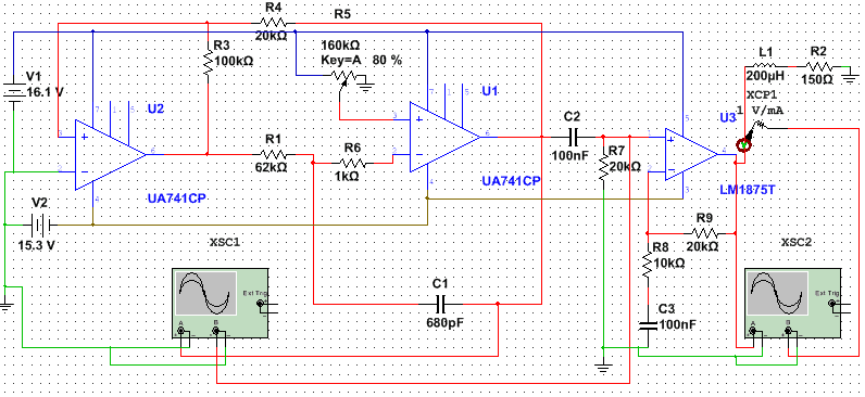

Hi
Does anyone have an idea of why my oscillator doesn't oscillate? It's supposed to generate sawtooth. But the scope shows constant -13V. Actually the output of the oscillator has a more stable voltage than the input voltage source!
It works IRL with ua741 opamp (but the 741 doesn't provide enough current for my application)
It works in simulation with lm1875t opamp.
While I was trying to debug and placing probes around the circuit all of a sudden it started to work... and after 30seconds or so it stopped just as sudden as it had started.
Then I took the components off the board and made a square wave generator circuit that worked. I checked both opamps and the capacitor with the square wave generator, so the components seems not to be defective.
Then I put them all back to the sawtooth generator circuit, and again it's output is constant -13V.
So I took a new breadboard, all new components, this time I added some potentiometers in order to tweak it a bit. Hopefully that would get it started, but it didn't. The output is barely changing when I turn the potentiometers.
I've tried 3 different capacitors; 2nF, 20nF, 200nF. It doesn't affect the output at all (except for the startup time when voltage drops from 0 to -13).
Something elementary must be wrong. Could it be that the lm1875t is to fast at voltage changes so it adjusts for feedback too fast and becomes stable? (I have never before used any opamp as powerfull and fast as the lm1875t.)
Any ideas where I'm failing?
Attached is a sketch of the latest test circuit with potentiometers.
Where did you get the circuit from? It would be good to see a source circuit -- I can kind of see how this one is supposed to work, but a couple things about setting the hysteresis are not clear to me.
So the main difference I see right off the bat is that the 2nd opamp's + input should be grounded (at least in the simplest implementation). Try turning your 160k pot so that it grounds the + input of the 2nd opamp...
There are loads of implementations of this circuit out there.
The 160k pot is the one that (in simulation) makes the difference in rise and fall time. When turned to ground the rise and fall times will be equal. Turning it away from ground changes the output towards sawtooth - in simulation.
IRL turning the pots doesn't make any difference at all. That includes turning the 160k all the way to ground - still got the ultimate noiseless DC output.
Can you label all the nodes in the schematic with the DC voltages from your simulation?
(Sketch in #1 was made in NI Multisim 30day demo, because it's the only simulator I found that has lm1875t in it's library.)
I've now created a similar circuit in Lt Spice. Using LT1366 as opamp it worked. Using LT1210 the simulation behaves just like my RL lm1875t circuit. LT1210 is faster and more powerful than lm1875t. LT1366 is slower and less powerful. This strengthen my idea that the issue I'm facing IRL is that the opamp is to fast/powerful for the circuit. It sounds strange though.
If that actually is the case, how can I modify the circuit to work with fast and powerful opamps?

You could leave the oscillator working with your low power op amps, and use its output to drive your high power amp (e.g. as a unity gain amplifier).
Trying to take a lot of power direct from an oscillator isn't a particularly good design idea, even if it does work. If your "large" load is not a pure resistance, you might be messing up the phase shifts in the oscillator circuit, which might stop it oscillating.
From your descriptions it seems like your "non-oscillator" has got one of the op amp outputs locked up to a supply rail voltage, which will certainly stop it oscillating - but I've no idea why that is happening.

Currently it looks like I've fried 4pc lm1875t. Voltage from powersource drops to +/-1,5V once connected to any of the 4 op amps I've used for testing. No load is connected, both inputs are grounded. Just Vcc and Vee is connected.
The LM1875 is specifically an audio power amplifier not an Op-Amp as such, its output is designed to drive a speaker, not the input to another LM1875
why did you choose this device ?
you should be using a more specific Op-Amp
Dave
I looked through the opamps listed on ebay and chose the first I came to that had enough output current and speed. I had no idea that some opamps can't drive another of the same kind.

I don't think you understood what I said ... these are not really op-amps as such
They are audio amplifier chips designed to drive speakers
You should really be using something like TL072 or similar for the actual oscillator ... once you have an osc working ... then you could use the LM1875 or some other audio amplifier chip to boost the output

I've now learned that oscillator based on lm1875 is not good.
Is ua741 suitable for driving the oscillator before lm1875 amplifies it?
(Those are the two kinds I have. If they're no good I'll need to order others, i.e TL072)
741 should drive an audio amp quite nicely.

I suspect that your trouble lies with LM1725's input.
The datasheet is a bit sketchy as to input impedance
http://www.ti.com/general/docs/lit/getliterature.tsp?genericPartNumber=lm1875&fileType=pdf
look at parameter "Input Bias Current"
so long as the amplifier can balance its inputs it draws only a microamp or so of input current
but the datasheet doesn't say what happens when input voltage differential becomes substantial as it does for U1. They don't expect us to use it that way. It's not a general purpose opamp.
Observe that in order to oscillate , your circuit must push or pull enough current through R1 to change state of U1.
and we don't know how much current that is.
Furthermore your unequal supply rails(more + than -) are in the direction to make U1's output stay positive , and your symptom(-13V out) agrees with that. There's less negative to pull current through R1 than there is positive to push it through R2 .
That's probably not an issue if R3 is set fairly high.
Lastly C1 can pass a LOT of current into U2's inverting input.
That can cause latchup in some amplifiers, see
http://www.ti.com/general/docs/lit/getliterature.tsp?baseLiteratureNumber=slya014&fileType=pdf
and that can be destructive.
I'd stick a kohm or two between U2 pin2 and junction C1-R5
It'd be very educational to get this working with 1725's.

Does this sketch look OK?
L1 and R2 represents the load.
The hardest part here was to make the amplitude into 1875 small enough for it not to clip, while trying to keep the rise and fall times as far apart as possible. This circuit gets a rise/fall time factor of 4.3 at 5kHz. I was hoping to reach 5.
I might be able to increase the rise/fall factor by getting a power supply that is symmetric (or adjustable)
10pcs of lm324 is ordered. ($1.70 on ebay including shipping. Local store would set me back $50 with unknown delivery time.) As shipping takes some time I'm thinking to go with ua741 in the oscillator, and use the 324s where the 741s originally was planned to be used.

not sure why you have 2 different voltages for your split rail supply ?
you should have them the same
also you oscillator part is a long way away from what Berkeman showed you in his earlier post
As I suggested before, replicate his circuit ( its out of a datasheet) so that you get your triangular wave
disconnect the input to the LM1875 for the time being and concentrate on getting your oscillator working
THEN you can worry about adding the amplifier
D
It's basically the same as Berkemans. I didn't bother to draw pots for fine adjustments, and it's tweaked to give sawtooth, not symmetric triangular, and it gives way smaller amplitude. The one Berkeman found will make the 1875 clip, hence make square wave.
My supply is double 15V on the sticker. Measured voltage is what the sketch show. Better to simulate with the real voltage than the theoretic.
And R6 is added because of the genius Jim. I adopted his solution for powerfull opamp circuit to the not so powerfull opamp circuit.

Something is not right with the amplifier circuit. (I have not connected the load yet.) Signal from U1 pin6 dies when the amplifier is connected. Even with C2 removed, still no signal from U1. When R7 also is removed, the signal comes back. Or if I leave R7 in and pull out R8 og C3 there is also signal from U1.
The circuit around the lm1875 is from the datasheet example for typical application.
If I replace C2 and C3 with 20k resistors, the signal from U1 turn into pulse with negative amplitude out of range for my scope. And the frequency is 10x what comes from the unloaded oscillator. Whats going on here?
jim hardy said:
What do you mean by " rise/fall factor " ? Up vs down slopes of sawtooth ? Is that what your 160K R5 adjusts?
Correct. Time of the up slope devided by time of the down slope (or the other way around).
Actually R5 adjust the fall slope length, and R4/R3 ratio adjust the rise slope length. By length I mean the diagonal distance from top to bottom (or the other way around). So they affect both amplitude and frequency.
R1 affects mostly frequency.
If R5 is set close to ground, then R4/R3 has less affection on frequency.
jim hardy said:
Looks like this would operate in the 10khz region which is about as far as you want to push a 741.
My target is between 4kHz and 6kHz. Should be within range for 741 and 324. Although the sawtooth requires faster change in output in a fraction of the cycle than what a symmetric triangle requires at 10kHz.
  • #31
Looks like the lm1875 is doing something that is messing up the supply voltage. With nothing connected to pin1 and only R9 (the feedback) + R8 (to ground) connected it's able to kill signal from the oscillator. At this point the only thing the two stages has in common is power and ground. Setting a 47k resistance between pin 1 and pin 2 on the 1875 makes the oscillator start oscillating again. So the amplifier circuit has to be modified so that voltage on pin 1 and 2 don't drift apart - as they apparently do with the current circuit.
  • #32
this could be part of it
The LM1875 is designed to be stable when operated at a closed-loop gain of 10 or greater, but, as with any
other high-current amplifier, the LM1875 can be made to oscillate under certain conditions. These usually involve
printed circuit board layout or output/input coupling.
that's from its datasheet
and you've set gain to 2
datasheet "applications" circuits are both set to 20.
And have a larger C3.

With gain at 20 (R9=20k, R8=1012) and C2 removed - this should give an amplifier with no input and no output load - I get the same behavior as with gain at 2, except that supply voltage dropped to 22,1V and the supply made some unfriendly sounds. Shorting out C3 did not make any difference.
It doesn't make sense that the powersupply can't drive one unloaded lm1875 when it surely had enough power to drive two of them yesterday - and kill them. Hence my logic say here is something very bad with the circuit.
  • #35
Let's focus on that a minute
datasheet page 3 says an unloaded 1875 can draw 100 milliamps
1. what is rating of your supply?
2. what do you read for DC output voltage, supply unloaded and loaded?
Measure + and - individually, not just across them
3. switch your meter to AC (or use your 'scope) and measure AC ripple voltage at same conditions .
That checks power supply for filtering and regulation.
