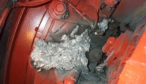

A synchronous generator that's heavily overexcited offline makes a highly distorted waveform and the induction heating melts holes in the stator iron.
Picture courtesy these guys: http://www.exponent.com/Generator-Core-Failure/
We wrecked a big one ca 1981.
I don't know yet whether a self excited induction generator can do the same.
