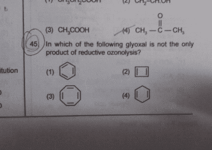

Hi you two, thanks for replying :).
the thing is, I just got into 12th, just finished, alcohols, phenols... i didn't understand a lot of what you guys said, my original question was this
I guess all the things you guys were talking about will be taught to me later(wont it? :frown: ) ,
could you help me solve this question for now? I selected answer D, which was correct because i thought it would give propandial and not glyoxal.. but the question says somethings else..
PS i hope you did well in your exams Aditya :smile:
D gives 2 moles of a compound other than glyoxal. All others give only glyoxal on ozonolysis. Waite for a few months. Soon you will learn it.
Exams did not go as planned. Atleast I can write jee advanced. The FIITJEE topper here scored 320 in mains.
But the first option benzene gives H2O2 other then glyoxal, so why it is not the answer for question?
And how come 4th will give glyoxal? To me it is looking propanedial. Is there some rearrangement here that 4th option is giving glyoxal?

But the question remains unanswered, that are we getting propanedial in 1-4 cyclohexanediene?
yes. 2 moles of propanedial.
And how glyoxal?
question is wrong?
AdityaDev said:
question is wrong?
It may be right, some rearrangement can be possible.
Also benzene is giving glyoxal as well as ZnO2.

I don't understand how glyoxal could be a product from option D,
even by rearrangement how can you get glyoxal,
Im sure. The question is wrong.

The file you have attached was not of a book?
Rearrangement based on torsional strain and something but I am not sure.
No rearrangement here. I am sure. Take chair form and do the mechanism.
Likes Raghav Gupta
  • #31
Okay I got all of the drama. All we were having were interpretation issues.
The question is correct and Suraj your answer D is correct.
The question is saying in which of the following glyoxal is not the only product.
All three of us might be thinking that the question is asking which of the following gives glyoxal as well as some other compound.
It is not like that.
It was a simple one and language confused us.
Clearly in D option we are getting propanedial the only product and not glyoxal.
This question was more of a language game then chemistry!
