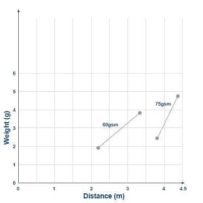

I'm doing an experiment to get my silver CREST award, in which I've created a mechanical paper plane thrower. I have thrown various types of plane, but all with the same design. The thrower uses a 9V battery, but is more like 6 now. The thrower has two motors, each which take 70mA. The thrower throws consistently with a percentage difference of each throw being <3%, and each plane spends around 0.3s on the launcher before leaving its grasp.
My results are as follows:
A4 75gsm plane weighing 4.7g travels 4.37m
A4 60gsm plane weighing 3.8g travels 3.33m
A5 75gsm plane weighing 2.4g travels 3.80m
A5 60gsm plane weighing 1.9g travels 2.20m
I am trying to find the number of joules each plane takes to get x meters, by finding the j/kg. The j/kg should give me m^2/s^2 which would enable me to work out the power required to throw a 1ton aluminium plane for 1km.
However, no matter how hard i try, i cannot get the equation to work for more than 1 value at a time.
Can anyone come up with an appropriate equation to work out power or energy from distance, weight and other measurable variables?

Well, you should have two formulae, one for each weight.
OK, hm. You want two parameters, weight and gsm.
Should i?
I want to be able to vary the weight to find the power. Surely i would have to fit it in the same equation?
To get power, you might divide work (the distance the launcher arm moves multiplied by the integral with respect to time of force as a function of time) by 0.3 s.
