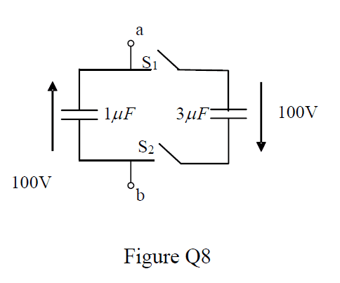

I'm just a bit confused about identifying the capacitors in this circuit as connected in parallel or series.
The solution is parallel, though I am unsure why.
Parallel and series capacitors are two different ways of connecting capacitors in an electrical circuit. In a parallel connection, the positive terminals of all capacitors are connected together and the negative terminals are connected together. In a series connection, the positive terminal of one capacitor is connected to the negative terminal of another capacitor, and so on.
The main difference between parallel and series capacitors is how they affect the total capacitance of the circuit. In a parallel connection, the total capacitance is equal to the sum of individual capacitances. In a series connection, the total capacitance is less than the smallest individual capacitance.
In a parallel circuit, the total capacitance (C) can be calculated by adding the individual capacitances (C1, C2, C3, etc.): C = C1 + C2 + C3 + ... In a series circuit, the total capacitance is calculated using the reciprocal of the sum of the reciprocals of individual capacitances: 1/C = 1/C1 + 1/C2 + 1/C3 + ...
In a parallel circuit, the voltage across each capacitor is the same as the total voltage in the circuit, while the current is divided among the capacitors. In a series circuit, the current through each capacitor is the same, while the voltage is divided among the capacitors.
Yes, you can mix parallel and series capacitors in a circuit. This can be useful when trying to achieve a specific capacitance value. However, it's important to properly calculate the total capacitance and ensure the capacitors have the same voltage rating to avoid damaging them.
