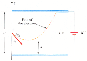

An electron is fired at a speed vo = 5.6 ✕ 10^6 m/s and at an angle θo = -40° between two parallel conducting plates that are D = 2.5 mm apart, as in Figure P16.66. The voltage difference between the plates is ΔV = 103 V.
F = Eq
E = V/d
a = F/m
I tried finding acceleration with (ΔV/D)(q/m) or 103/.0025 * 1.6e-19/9.11e-31
I found Vy with 5.6e6sin(40)
Then i used vyf^2 = vyo^2 + 2aΔy to solve for Δy
then i subtracted my answer from .00125 m and got .54 mm, but the website says I'm off by more than 10%.
I haven't tried part B yet because i could have acceleration wrong and that will just mess up both answers.
Don't forget gravity, or at least check how it compares with the acceleration of the electric field.
Write down equations, instead of narrating your calculations.
The acceleration was something x 10^15 so i figured gravity was negligible.

Hi laurajean997. Welcome to Physics Forums.
Can you show your attempt in a bit more detail? In particular, show the values that you obtained for the intermediate steps.
