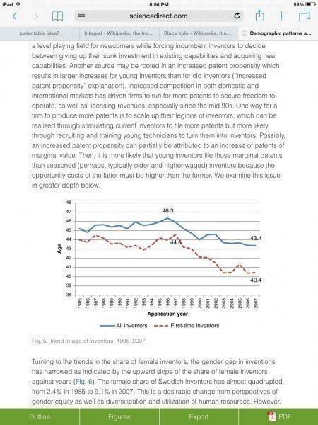

Of course, inventions are often made by comparatively young people and not seasoned veterans, so when you're sure to have something in your hands, you should not discuss it publicly to keep patentability. But I don't think this is the case, it's just another feedback you could apply to this system. The question is whether it's worth it or not.
You make it sound like only young people are the primary inventors in fact it's more likely that inventions will come from someone outside a given field not that they are simply younger. It has to be someone who doesn't know the limits or has a knack for seeing things that need fixing.
http://www.sciencedirect.com/science/article/pii/S0040162513001911
From this study the average age is 40-45, the age is getting younger which attributed to the tech revolution we are in but to me that's middle aged.
