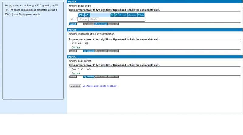

Pls see the attachment.
Obviously I have B and C correct but for a the only thing I can find is tan(phi)=XL-Xc/R
This seems to be for a series RLC circuit though and I only have RC.
also I know that the current lags the p.d by 900 in an RC circuit but I can't see how I can use this?
any help appreciated.

Phase angle can found by using
cosφ = R/sqrt(R^2 + XC^2)
I don't know capacitive inductance though?
Sorry. It should be XC. = 1/ωC
Thanks that worked, although the answer was negative 89 degrees?
You can use the equation tan(phi)=(XL-Xc)/R for a series RCL circuit, even for XL=0 as it is the case now.
