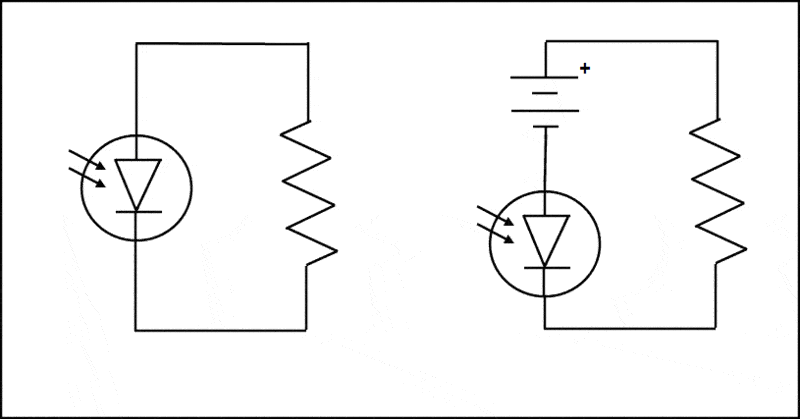

Hey guys, just another question regarding photonics. From looking at an I - V characteristic of a typical photodiode:
http://www.rp-photonics.com/img/photodiode.png
I don't understand what it means by there being a negative voltage and a negative current. I suspect the negative in the current simply means that the charged particles move in the opposite direction mean while i don't understand what the negative voltage would mean. Is the negative voltage there because a supply of charge carriers are entering the diode from the power supply?

Most of the time, yes, the photodiode current will be negative. Look at the I-V curve again. If enough forward voltage is applied to the photodiode, the current will become positive. But this requires connecting a battery or other voltage source to it, with a positive polarity in the connection. Also, there is really no useful reason to put a positive voltage on a photodiode, as then the signal would be very insensitive to incident light level
If you simply connect the photodiode to a resistor only, the current will always be negative -- or zero, if there is no light hitting it.
2. If this is the case then why do we refer to negative current?
If there is no light hitting the photodiode, it's I-V curve will behave just like a regular diode. There is a standard convention for positive and negative current directions in regular diodes, and it makes sense to keep that convention for all diodes: photodiodes, LED's, and laser diodes too.
It happens that in a photodiode, the current generated by incident light goes in the opposite direction to the normal conduction direction of a regular diode. So this current is negative, by agreed convention.
3. How can we have negative voltage?
By connecting a battery to the photodiode, it is possible to have a negative voltage across it. This is a useful way of getting a linear signal (i.e., one that does not saturate) over a wide range of light levels.
By the way, I've attached the two circuits used to generate the dashed-line traces shown in the photodiode I-V curve from message #1 of this thread:
Perhaps this will help to better understand the I-V curves.
