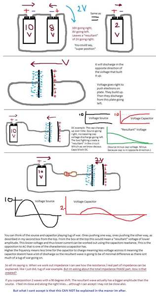

Hmm it still doesn't really add up. I think there might be a lot of terms flying around that arnt properly explained / defined.
Let me give an example.
In the beginning this is what I thought.
A circuit that has an AC source and capacitor. (I know you need a resistor but bare with me)
Now, I thought that, you turn the AC on, the capacitor charges up and then you have a voltage produced by the capacitor coming out the other end that is lagging the source voltage.
So at the side before capacitor will have say 0 voltage and 0 current but on the other side of the capacitor in that part of the circuit will be max current and max voltage. And that this is what the phase shift means.
But then I found out I was wrong as current is the same through the whole circuit. So the current before and after the capacitor is the same.
So then this is when I realized about Reactance. As the voltage starts to decrease from the source (after the capacitor has been charged) the capacitor starts to discharge because the capacitor now has more voltage than what's being applyed to it at that time. This discharge as well as the existing voltage from the source combine together to make a resultant voltage.
This voltage intern creates a current and the current size is as if there was a resistor that has the value of the capacitors reactance.
One thing I don't like is when voltage and current is spoke about it leading and lagging beacuse they can't never lead or lag, there has to be a voltage to be a current, but in this case, the CAPACITORS voltage lags the SOURCEs current. and the current in the circuit is a combination of the 2 voltages.
So now that's all fine...but then the phase shift thing. current in the circuit has a phase shift with respect to SOURCE voltage. But what creates the OVERALL phase shift.
I see how it can create an impedance from the discharges = resultant voltages, but how and where does the TOTAL phase shift respect to source voltage in the circuit come into it / how is it created (qualitatively in the same style of my reactance explanation) ?
This is what I am trying to understand

Lets say we had a resistor at 10Ohms and Capacitor Reactance at 20Ohms.
Total impedance in the circuit would be 22.36Ohms at -63 degrees.
How does the -63 work. I know it means the current in the circuit will be leading source voltage by 63 degrees but HOW, what is happening to make it that / actually create a phase shift from source.

Ok so maybe I've got it.
with have an AC source, resistor and capacitor
1) the capacitor can only charge up to the max voltage after the drop,
2) once the voltage after the resistor is less than what the capacitor is charged up to, the capacitor starts to discharge
3) the voltage produced from the capacitor is 90 degrees lagging the source voltage
4) the combination of the 90 degree lag smaller voltage going left + the original source voltage going right add together (superposition) to create a final resultant voltage in the circuit of a certain amplitude and phase.
5) but as it takes time for the capacitor to charge, the frequency of the ac source will effect how much charge the capacitor will have once it reaches its peak voltage. Thus meaning at higher frequencies less voltage will be discharged meaning the resultant waves amplitude will be effected less than at lower frequencies. This then shows why reactance is 1/wC. As the reactance is in Ohms, the capacitor will look like a smaller and smaller resistor...backing up the fact the resultant wave will be closer in amplitude to the source voltage than at lower frequencies.
Ive made a few graphs using excel, and after adding wave 1 with amplitude of 10 and wave 2 of amplitude 6 with a 90 degree shift, I get a resultant wave that has an amplitude larger than 10.
However, changing the second waves amplitude does effect the resultants phase with respect to the first wave.
So what is wrong in my explanation? I am sure there's just one tiny piece I've forgot/missed out/haven't realized...hm

Ive tweaked my theory / explanation a bit.
1) the capacitor can only charge up to what the capacitors time constant let's it to at a given frequency. Higher frequency will mean it has less charge thus less voltage across it because it has less time to charge up. So capacitor is charged to something less than AC source.
5) Due to higher frequencys meaning the capacitor has less charge and less voltage, for it to be able to discharge it needs to wait longer for the AC source to meet the capacitors voltage and go less. This would mean there would be MORE than a 90 degree lag with the discharge. As say the AC source peaked up 10V and the capacitor only charged to 2V then it has to wait to almost the end of the cycle for it to be able to discharge (when AC source reaches back down to 2V and less). This makes the phase shift closer to 180 and not 90 (in this case).
4) the combination of the capacitors discharge smaller voltage going left with over 90 degree lag + the original source voltage going right add together (superposition) to create a final resultant voltage in the circuit of a certain amplitude and phase.
How does that sound?
Please bare in mind all this I am coming up with is on my own (with the help of you guys) as anywhere else I look it is just equations and I am trying to rewrite it in physical happenings.
So any help on fixing my "theory" or pointing out where I am going wrong if at all would be helpfull.

Ah, that's because it doesn't *change* an existing current. Instead, without a capacitor connected, there was no current there to begin with. It doesn't shift a current, instead it acts like a load which is drawing a lagging current. Was that your problem? Another problem: we can't suddenly connect a capacitor across an ideal voltage source or across a square wave without creating infinite current.
But back up a little. It might help to ditch the sine waves at first. Instead, visualize what happens when we connect a capacitor in series with a resistor, then apply a square wave voltage source across the two. (Assume that the capacitor voltage started out zero.)
If the square wave suddenly goes positive 1.0V, then a charging current appears in the circuit, and the 0Vdc capacitor voltage begins rising towards +1.0V. OK so far? If the cap value is small and the square wave period is far longer than RC, then the capacitor voltage will climb very close to +1.0V. But what happens if instead the cap value is large, and the square wave quickly switched negative? In that case the capacitor current reverses, and the voltage across the capacitor starts falling towards -1.0V. If the period of our square wave is lots faster than the RC time constant, then the capacitor voltage never had any chance to approach 1.0V before the square wave reverses it's polarity again.
In that case, the waveform of the capacitor voltage will be a triangle wave.
OK so far? Two voltage signals: square wave in, triangle wave out. Fast square wave, and a slow-charging long RC constant.
Now ask yourself this: is that triangle wave in phase with the square wave? (Go and change both waves a bit, so they look closer to sine waves.) Nope, they're not in phase. The peaks of the triangle wave don't line up with the middle parts of the square wave. Instead they line up with the rising and falling edges of the square wave.
So, if both waves are morphed into sinusoids, then we'd see that the capacitor voltage lags behind the drive voltage by ~90deg.
Why? Obviously it's because the drive waveform turns on first, then the capacitor voltage rises later. And the capacitor voltage hits its max value exactly when the square wave reverses it's polarity.
NOW the AC math tools come in. Given R, C, and jw values, you can show that the output phase lag is very close to 90deg for large RC and high frequency drive voltage.
Then go to http://www.falstad.com/circuit/ circuit simulator. Set up the same squarewave capacitor circuit and watch the charges flowing inside the schematic connections. I used the given 40Hz square wave, 100ohm resistor, but changed to 300uF cap. Add analog outputs to the drive and to the capacitor, and turn them on as scope displays. You can even add a SPDT and a 40Hz sinewave source, so you can easily switch back and forth from square driver to sine.
When you understand all that, then set the cap value to 1u and see how the phase lag now gets very close to 0deg.

So, this is what I am come up with so far, an AC source, resistor and capacitor all in series...
1) Higher the frequency the shorter the time the capacitor has to charge up, meaning less voltage across the capacitor at its maximum.
3) Due to higher frequencys meaning the capacitor has less charge and less voltage, for it to be able to discharge it needs to wait longer for the AC source to meet the capacitors voltage and go less. This would mean there would be MORE than a 90 degree lag with the discharge. As say the AC source peaked up 10V and the capacitor only charged to 2V then it has to wait to almost the end of the cycle for it to be able to discharge (when AC source reaches back down to 2V and less).
4) the combination of the capacitors discharge smaller voltage going left + the original source voltage going right add together (superposition) to create a final resultant voltage in the circuit of a certain amplitude and phase.
Thus a 56.3 shift as per my example. Which is dependant on frequency and capacitance to calculate reactance which is point 1, 2 and 3, and reactance I had explained without maths in a few posts before...
I realize this explanation is not 100% spot on, but I think its a long the right path but needs to be tweaked...
Hopefully this makes people realize what kind of explanation I am after.
