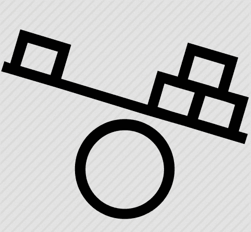

Cyclist on a teeter-totter? A diagram or picture would probably help...
I'm not given a diagram...sorry.
Here you go. Happy to help...
https://cdn3.iconfinder.com/data/icons/science-2-8/48/192-512.png
