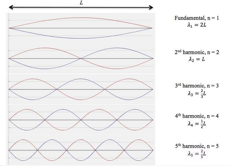

A string that is 6m long is vibrating with 3 loops in it. The frequency of the source is 16.5Hz.
What is the fundamental frequency of the string?
For the life of me I can't figure out how to solve this question. I found out that the wavelength is 4.8m but that's about it. If I use the equation fn = nf1 this is all I seem to be getting when I plug in the numbers. fn = 1 * 16.5Hz which is still equal to 16.5Hz...Id like to know what I am missing here.

Please stop deleting the Homework Help Template. It is important for you to start your schoolwork threads using that template. For example, what are the "Relevant Equations" for this type of question?
Also, when there are "3 loops", what does that look like? Can you post a figure or a sketch? And when the string is vibrating at its fundamental frequency, what does that look like?

Well, it's pretty easy to use Google Images to find figures that can help you figure this out. I did a Google Images search on string harmonics, and got lots of figures like this one:
https://soundphysics.ius.edu/wp-content/uploads/2014/01/harmonics.jpg
So when you say "3 loops", is that like the 3rd harmonic diagram? And what is the relationship between the 3rd harmonic and the fundamental frequency?
The third harmonic diagram would be accurate to the equation. I am not sure what the relationships is between the third diagram and the fundamental frequency.
Count the little loop thingies... :wink:
