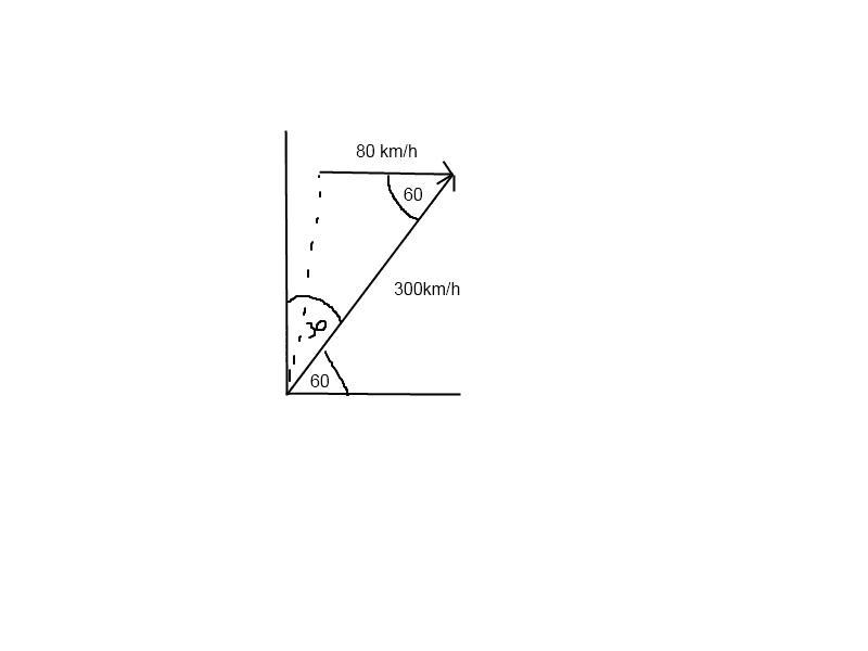

The navigator of an airplane plans a flight from one airport to another 1200 km away, in a direction 30 degrees east of north. The weather office informs him of a prevailing wind from the west, of 80 km/h. The pilot wants to maintain an air speed of 300 km/h.
a) What heading should the navigator give to the pilot?
b) How long will the flight take?
c) How much time did the wind save?
I drew the diagram out, but i didnt know how to solve it.
There are two approaches. You can use law of sines and law of cosines to solve the triangle, or you can convert all your vectors to rectangular x and y components and work out the x and y parts separately.
i was wondering if this diagram was correct?
No, it should be like this:
The red airspeed plus the windspeed adds up to a vector going at the desired angle 30 degrees E of N (groundspeed).
kk thank you, no wonder i kept getting the wrong answer
