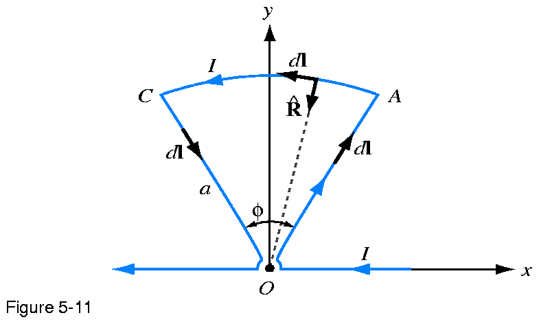

Pie shaped loop of radius a carraying a current I
In summary, the conversation is about using the Biot-Savart Law to determine the magnetic field at the apex of a pie-shaped loop, with a discussion about shortcuts and the contributions of current in different parts of the loop.
aimee
I have been trying to do this for hours...
I know I'm supposed to use the Biot-savart Law: dH = IdLsin(theta)/4pir^2
Determine the magnetic field at the apex of the pie-shaped loop shown below. Ignore the contributions of the field due to current int he small arcs near 0.
What have you done so far?
If you write the Biot-Savart law like this, you may see a few shortcuts:
[tex]d\vec{B} = \frac{\mu_0 I}{4 \pi} \frac{d\vec{L} \times \hat{r}}{r^2}[/tex]
What can you conclude about the contribution to the field due to the current in the straight wire pieces? What about the curved piece?
