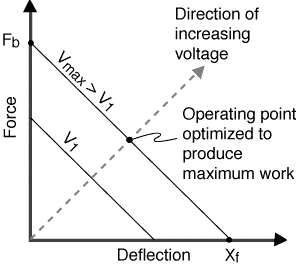

Ceramic would have bigger response and a lower cost than quartz. But there is no need for such a big pickup.
Your pickup transducer needs to be sensitive to the string movement and deaf to room noise. A large single transducer will also pick up other noise in the room, which will then feedback around the amplifier system.
To use piezoelectric transducers you must find a coupling system couples to the string while cancelling room noise.
As Baluncore mentions, "To use piezoelectric transducers you must find a coupling system couples to the string ...".
I'm thinking that any mechanical coupling would surely dampen the string vibration too much.
http://www.piezo.com/tech2intropiezotrans.html
I certainly do not advocate close mechanical coupling, or a piezo microphone nearby.
There are good reasons why magnetic pickups are used.
String vibration is a 2D thing, often with a rotation between the modes.
How might the orientation of piezo sensors change the sound recovered?
