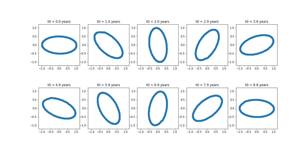

I'm tasked with drawing the trajectory of the Moon around the Earth (in 2D), taking into account the fact that the trajectory also undergoes precession, so the elliptical orbit rotates about it's center (I think it should rotate around the Earth-Moon barycenter, but for the first step I neglected this).
So I approached this by first parametrising the elliptical orbit:
$$ \vec{r}(t) = <a cos(\omega t), b sin(\omega t) >,$$ where ## a ## is the semi major axis, ## b ## the semi minor axis and ## \omega ## the average angular velocity of the Moon around the Earth. Due to the extremely low eccentricity of this orbit I just used the average angular velocity as an approximation instead of worrying about its time dependance.
To add time dependant rotations, I multiplied this vector by the rotation matrix:
\begin{bmatrix}
cos(\Omega t) & sin(\Omega t) \\
-sin(\Omega t) & cos(\Omega t)
\end{bmatrix}
where ## \Omega = 2 \pi / 8.85 ## years is how fast the orbit precesses. The end result is:

However, when I plot this the ellipse doesn't rotate at all. I tried changing the periods of the rotations to see the rotations come into play sooner - didn't help. I think my code is right so I'm skeptical about the physical aspect. Is my coordinate system somehow rotating with the ellipse and I therefore don't see the rotations?

I think you've done it right. I coded it up and the orbit rotates. See the attached plots. I made the eccentricity large enough so I could see it. if you didn't do that, maybe you just can't see it rotating?
Likes berkeman
Oh wow you are completely right. The eccentricity is way too low to actually notice it rotating... Thanks a bunch for the help, turns out I'm just a dumdum.
