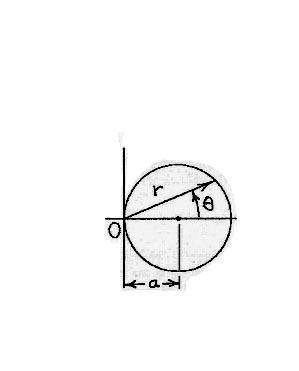

A particle moves on a circular orbit in a central force field. The origin of the force lies on the circle.
Find the polar equation of the orbit.
I am confused as to how to set up this question.

Start with the equation for the invers radius of the orbit with respect to angle
[tex] {d^2u}\over {d/ \theta^2} + u = [/tex]
Can't work it right now, back later... anyway it is r^-5.
I need a few more steps to be explained. I am sure that if you could please explain them to me that I will get it.
Also, I ahve never sen that queation before. IS it derived somewhere on the net?
Are you saying that the polar equation is r^(-5)? I need some help here desparately.
My typing is bad, and it was late.
Start with Goldstein 3-34a,
[tex] \frac{d^2 u}{d\theta^2} + u = -\frac{m}{l^2u^2}f(1/u) [/tex]
set [tex] 1/u = 2acos\theta [/tex] and crank away. The answer should pop out when you eliminate the [tex] \theta [/tex].
