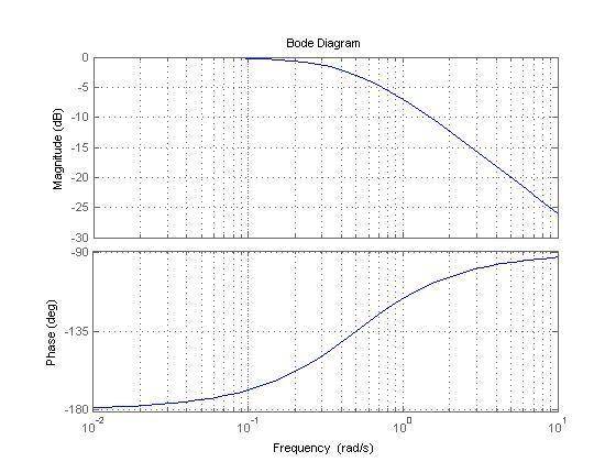

Understanding the bode plot for,
[tex]G(s) = \frac{1}{2s-1}[/tex]
Usually when I am drawing bode plots for either real poles or zeros, I simply solve for the break frequency knowing that a zero/pole will give me a +/-20dB/decade asymptote after the break frequency on my magnitude plot, and a +/-90° phase shift across two decades, with the center (i.e. the +/-45° point) at my break frequency on my phase plot.
This has always worked when I have,
[tex](s+a) \quad a>0[/tex]
but it seems to change when,
[tex](s - a) \quad a>0 \quad \text{or, } \quad (-s+a) \quad a>0[/tex]
I can't wrap my head around why a pole has an increasing phase that starts at -180°. I was expecting a phase decrease from 0° to -90°.
Can someone explain what I am misunderstanding?

You did solve the bode plot correctly.
When a pole is in the right half plane (greater than zero) the phase will increase during the pole.
It is important to note that this means the system is unstable.

I'm not sure why you would expect that. When in doubt, go back to basics:
[tex]
\left. H(s) \right|_{s = j\omega} = \left. \frac{1}{2s - 1} \right|_{s = j\omega} = \frac{1}{2j\omega - 1} = \frac{1}{-1 + j2\omega} \Rightarrow\\
\arg(H(j\omega)) = \arg\left(\frac{1}{-1 + j2\omega}\right) = \arg(1) - \arg(-1 + j2\omega) = 0 - (\arctan(-2\omega) + \pi) = -\arctan(-2\omega) - \pi
[/tex]
Try evaluating that for [itex]\omega \ll 1[/itex] and [itex]\omega \gg 1[/itex].

It's true that the Bode plot for an unstable system does not give you information about its steady-state gain and phase shift (since it has no steady state to speak of), but that doesn't mean the Bode plot itself is undefined, which, if you read my post carefully, was what I was commenting on.
[itex]H(s)\rvert_{s = j\omega}[/itex] evaluates fine for [itex]0 < \omega < \infty[/itex], be it for a stable or unstable [itex]H(s)[/itex].
