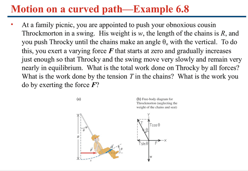

Regarding the question "What is the total work done on Throcky by all forces?" I originally thought it would be the change in mgh, but my Physics teacher said that because he's in equilibrium between the force F and gravity, net force on him is 0, and so is work.
The question asks for the total work done by all forces. Not a very common way of asking such a question, but in general, conservation of energy demands that the sum of works done by balanced forces must equal zero:
W(applied force) + W(gravity) = 0
But in your first example, you seemed confused about how the block can gain potential energy. Potential energy is the other work. So you seemed to be asking a different question.
The difference is whether you are asked to find one work, the other work or the sum of both.

No, as you said the total work is zero.
I'm not sure what the issue is here. You see that there are two forces being applied to the block, right? Do you see that the forces point in opposite directions? Do you see that asking about the total work is different from asking about the work done by the upward force?
