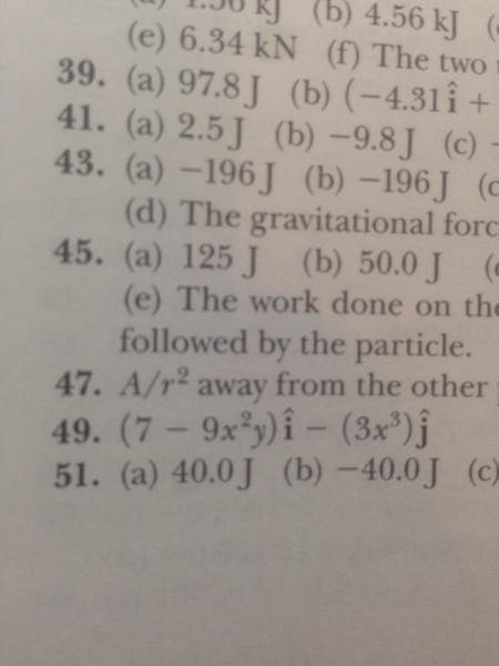

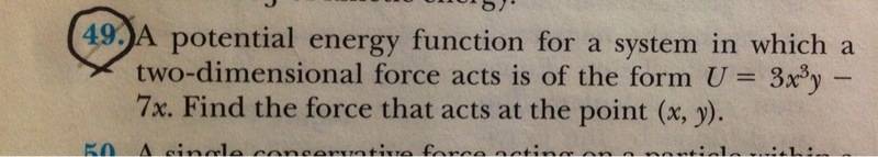

To find the force we will differentiate the function with respect to x (dx)
My problem is with the solution
If we differentiate:
dU/dx = 9x^2 - 7
From where does the negative come from also the j component?
You should have used the homework template, then you have written the relevant equations. What equation is relevant for finding force from potential energy?
F = dU/dx
That is not correct.
Correct me if I am wrong
Why are you disregarding the y-component when you differentiate?
