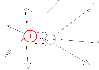

The arrows show the field lines in the figure. What do you think, is the uncharged (gray ) body at positive or negative potential with respect to infinity? Is it at lower or higher potential than the positively charged body?
Ok,got it..
For the gray body,the charged conductor will act as a point charge and impart some potential to it..
KQ/d which is going to be lesser than KQ/R (R is radius of charged conductor),
as R is obviously smaller than d...but,the potential is still positive,so it's greater than the potential at infinity..
That would mean option A.
Correct??

Looks good.
The potential decreases in the direction of the electric field, so it is higher at finite length than at infinity.
The positively charged body induces some negative charge on the closer surface of the neutral body, and some field lines connect some positive charge with the negative charges between the bodies; so the potential decreases from the charged body to the neutral one.
