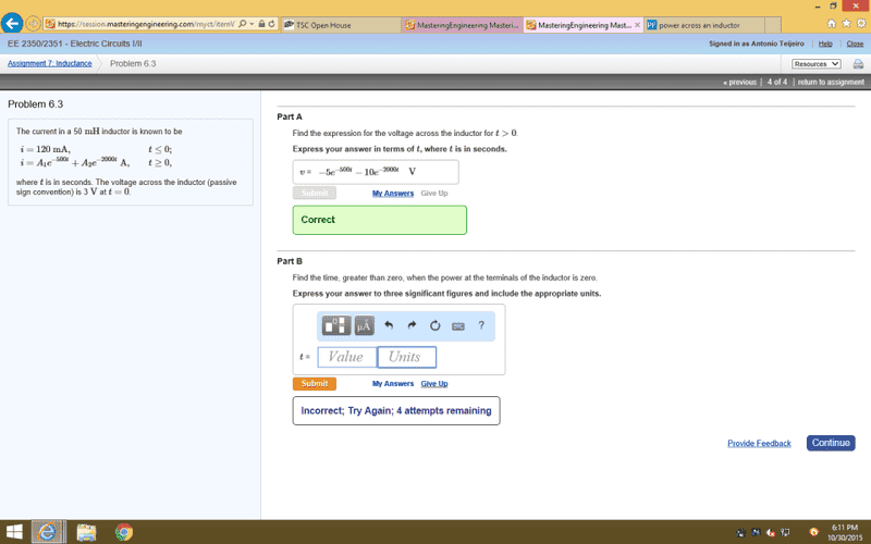

Find the time, greater than zero, when the power at the terminals of the inductor is zero.
i(t) = .20e-500t + .1e-2000t A
v(t) = -5e-500t-10e2000t V
L = .050 H
v(
P=VI

The problem statement was not very specific. Did you state the problem exactly word for word?
Are we to interpret the current i(t) as the current in the inductor? Does v(t) represent the potential difference across the terminals of the inductor? Assuming the answer is yes to these two questions, how would you write an expression for the power delivered to the inductor as a function of time?
Yes, there is no information missing.
P = VI = Li(di/dt)
OK. The voltage function v(t) represents the voltage across the terminals of the inductor.
Yes, P = IV. So, what mathematical expression do you get for the power as a function of time?

Those values are not consistent with your statement of the problem:
For example, when ##t = 0##, ##i = 0.3 \ \mathrm{A}## (edit) and ##v=-15 \ \mathrm{V}##.
Im sorry it will no let me edit the problem. the expression for voltage is supposed to contain e-2000t rather than e2000t
I arrived at P = -e-4000t-2.5e-2500t-e-1000t
You'll still get -15 volts at ##t=0##.
Can you briefly explain how you determined the answer for part A?
I treated i(t) as the general solution to a differential equation, with the initial conditions i(0) = .120A and Li'(0) = 3V. Using this approach i solved for A1 and A2. I then used this solution in v = L(di/dt) to find the expression or the voltage
You have the initial condition i(0) = 0.12 A. But, as Mister T pointed out, your expression for i(t) gives i(0) = 0.30 A (edited) which does not agree with the initial condition i(0) = 0.12 A
Wow. I am not sure why the v(0) yields 15 and i(0) = .3. i think it may have to do with the fact that there is a disconinuity in the current equation at t = 0, but my head hurts too much at this point to ponder it further. I am going to leave it alone for a few hours.
When I read the OP I took the given expressions for voltage and current to be, well, given. Now that I know the original problem statement I can see that there's a problem with the expressions (and this has been pointed out by others checking the expressions against the given initial values). RMZ, you need to check your solution to the differential equation. In particular, your value of the a2 coefficient seems suspect to me.
Once that's sorted, check to see if either i(t) or v(t) has a zero.
There's no discontinuity there. Note that prior to ##t=0## the current is constant (steady state) allowing you to calculate the resistance of the inductor.
