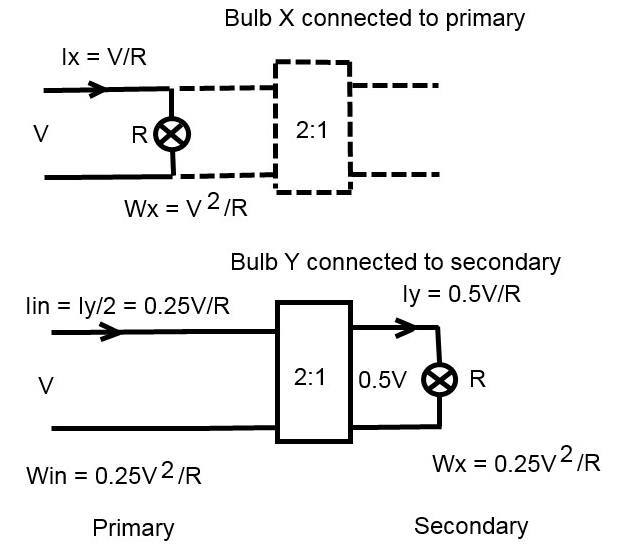

Then in the following question how should i calculate.
Two identical light bubls x and y are connected respectively to the primary and secondary coils of an ideal step downtransformer.The turn ratio of the transformer is 2:1.Calculate the power dissipated in x and y.
method 1: i^2r x:y=1:4
method 2: v^2/r x:y=4:1
method 3 :vi x:y=1:1
why would be 3 different result?also shouldn't the power in primary =power in secondary?

But shouldn't iy have double current that of ix?
x and y are not the same circuit so Ix and Iy are not related by the transformer equation...
Circuit "x" has the bulb connected to the primary. In that situation there is nothing connected to the secondary of the transformer so the secondary current is zero. Therefore the current in the primary is also zero. The current in the bulb is V/R.
Circuit "y" has the bulb connected to the secondary. The current in the secondary is 0.5V/R (It's 0.5V because it's a 2:1 step down transformer). The current in the primary is equal to half the secondary current or (0.5V/R) / 2.
I will try and do a drawing later. Have to go out for a few hours.
then what if the light bulb in primary coil is connected with the light bulb in secondary coil. i mean they are in the same circuit.
Then the current drawn from the source V is just the sum of the two (kirchhoff's current law).
Itotal = Ix + Iin = (V/R) + (0.25V/R) = 1.25V/R
Everything else is the same.
