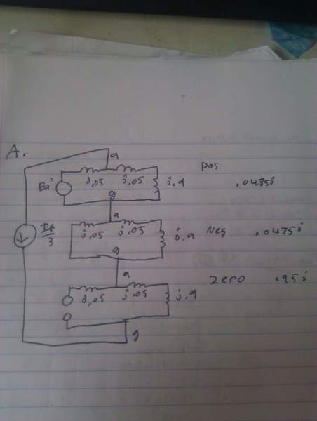

How to Incorporate Generator and Load Grounding in Power Systems Analysis?
In summary, the problem at hand involves analyzing a circuit with generators and loads that are not grounded. The equations used for this problem are the same as those used for a similar situation without grounding. However, there is a need to incorporate the effects of grounding, represented by Zg, into the analysis. The goal is to determine where to place Zg in the positive, negative, and zero sequence networks in order to find the Ztotal for each sequence and solve the problem. A diagram of the circuit and more equations may be necessary for a more detailed solution.
hockeyadc
I've attached the problem as it is easier to understand/view the circuit outline this way.
If/3 = Ea/Ztotal
Vag+=(If/3)*Ztotal(positive) +1
Vag-=(If/3)*Ztotal(negative)
Vag0-(If/3)*Ztotal(zero)
I know how to complete part A, the positive, negative, and zero sequence networks. I also have this problem completed for a similar situation, but the generators and loads are not grounded(i.e. no Zg). The above equations were also used for the problem regarded them not grounded, so I'm not sure where the changes occur. If more detail/equations are need let me I know I will do the best I can to add what I have written down. (Its kinda tough putting these equations/ diagrams up in words)
Sorry forgot to attach the problem. I've also attached a picture of what I have for part A. I believe this is correct, but again, this is what I've done when there was no Zg? So where does this Zg come into play? As well as the reactances for the generator?(X+.-.0)

I really just need help determining where to put Zg for the generators and the loads...As in, how would I represent it within the positive, negative, and zero sequence networks? Then I can find my Ztotals for each and proceed.
