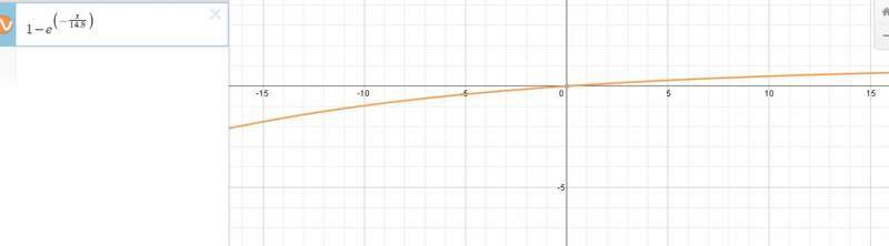

please help me with plotting of graph between "current versus time" for precharge resistor- 2.2 kΩ 20W.
this is placed across a contactor,which is linked to a motor controller with capacitors of value:6768μF.
closing time of resistor is calculated as 2.97 sec!

i have calculated time constant using formula 5T=R*C, and it is coming 2.97 sec! but when i am plotting the graph of voltage versus time using formula v= 1-e^(-t/rc) graph is coming linear instead of exponential. where m i going wrong?
i have also used the formula v=e0(1-e^(-t/rc)), from this graph is coming exponential but time constant is coming very large. around 150 it is showing steady state!
battery voltage is i.e e0 =148v
r=2200 ohm,c=6768μF
i m really confused.what to do?
i have attached the graph which i have got.

T = RC == 14.88. 5 time constants represents settling time, which gives 74.45 seconds.

and you are saying correct that it will come 74.45 sec,but since our application is electric vehicle,it is practicaly impossible to wait for that much time before vehicle can start.so, I am apprehensive about it.
For the precharge circuit - the number of Time Constants needed is to get to within ??% of the full battery voltage, and then allow the main contactor to close. 3 TC = 95% of the voltage... with 2.2K Resistor ~ 3*TC=45S, double up the resistor ( parallel) ~23 Sec, or 2 TC = 85% of the Full voltage. --
This issue is not to get the current down to a manageable value during precharge, it is how much current in-rush to the capacitors can you accept at the end of the precharge cycle - when the main contactor closes? Look at the contactor specs - it may provide some info on number of operations at Current = I -
The better you can define what you need to do ( with real numbers) the better you can find the best technical solution.
How much time do you want to spend to precharge to 5T? If the answer is 3 sec, then tau= 0.6 so R must be 0.6/6768uF = 88 ohms.
You need to decide:
1. How much settling do you need. Perhaps 5T is overkill (as Windadct said)
2. How large a precharge current you want to deal with (not sure what the limitation is here).
