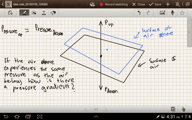

This does not contradict the idea of a pressure gradient. The statement is that pressure is applied in all directions uniformly, at a point. It should be easy enough to see that pressure at a point in a pressure gradient only has one value even though pressures at two slightly separated points will have different values.
I am still confused. The reason the air below has higher pressure is because it subject to greater pressure from the air above it..but then it applies the same pressure above it. So it wold seem that the air above should be subject to the same pressre.
That picture shows two different points/surfaces at two different elevations. The principle we are discussing is the pressure at a single point.
Let's go back to your original statement in the OP:
I am having trouble with the notion that pressure is applied to all sides uniformly.
This statement is not a correct statement of the law you are trying to investigate. The correct statement is pressure at a point is the same in all directions.
So let's say we take the point to be the black dot in between the two pressure vectors in my diagram. Then the pressure applied from that point is the same upwards on the blue surface as it is downwards. So then shouldn't the blue dot be subject to the same pressure as the black dot?
I guess I'm not clear on what the diagram shows. I see a black dot on a black surface and a blue dot on a blue surface above it. You've drawn two force vectors connected to the black dot, equal in magnitude and opposite in direction. All fine.
The blue and black surfaces are at different elevations, so the pressure at the blue and black dots are different. Why would you think otherwise?
You seem to be saying the black dot is applying a force on the blue dot. How? They aren't touching each other.
I don't understand conceptually why the pressure is different at different altitudes. If we say its because air closer to the surface of the Earth (S1) is subject to the total pressure of the air (Pt) above it, than I have some kind of paradox because then the air at the bottom (S1) exerts a pressure upwards that is equal to the total pressure (Pt) of all the air above it. Then the air right above S1 is also subject to a pressure Pt, and then it should also exert a pressure Pt.

That makes more sense. What I don't understand though is that if the forces on the top and the bottom of the packet are different, how come the packet doesn't experience a net upward force and accelerate upwards? I think this is what is confusing me.
Draw a free body diagram of the packet. Make sure you include all three forces. I assure you, they will sum to zero.
Oh..I forgot to include the force of gravity on the packet. Why is though that we calculate the pressure of a packet based solely on the packet on top of it. If we look at the second to last packet on the ground. It experiences a downward pressure of 99,998W/a and an upward pressure of 99,999W/a. So doesn't have a net pressure of 1 W/a?
