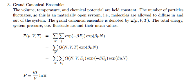

Can someone take a look at picture and show me how to derive the pressure from the grand partition function ?

Grand potential ##\Phi_G = -PV##
Grand potential ##Z = e^{-\beta \Phi_G}##
Thus, ##PV = kT ln Z##
Unscietific,
I can't use the fact that the grand potential equals -PV because my goal is to prove that the grand potential in terms of the partition function is equivalent to (-PV).
I know that those sums on the left side must equal (PV/KT) but I don't know the details of how to show it.
Rawrzz said:
Unscietific,
The grand partition function is sum of all states ##Z_G = \sum_i e^{\beta(\mu N_i - E_i)}## and Probability is i-th state over all possible states: ##P_i = \frac{e^{\beta(\mu N_i - E_i)}}{Z_G}##.
[tex]S = -k\sum_i P_i ln P_i = \frac{U - \mu N + kT ln (Z_G)}{T}[/tex]
Rearranging,
[tex]-kT ln (Z_G) = \Phi_G = U - TS - \mu N = F - \mu N[/tex]
Now we must find ##F## and ##\mu##.
Starting with partition function of an ideal gas: ##Z_N = \frac{1}{N!}(\frac{V}{\lambda_{th}^3})^N##, what is ##F##?
Using the below relation, how do you find ##\mu##?
[tex]dF = -pdV - SdT + \mu dN[/tex]
Putting these together, can you find ##\Phi_G##?
