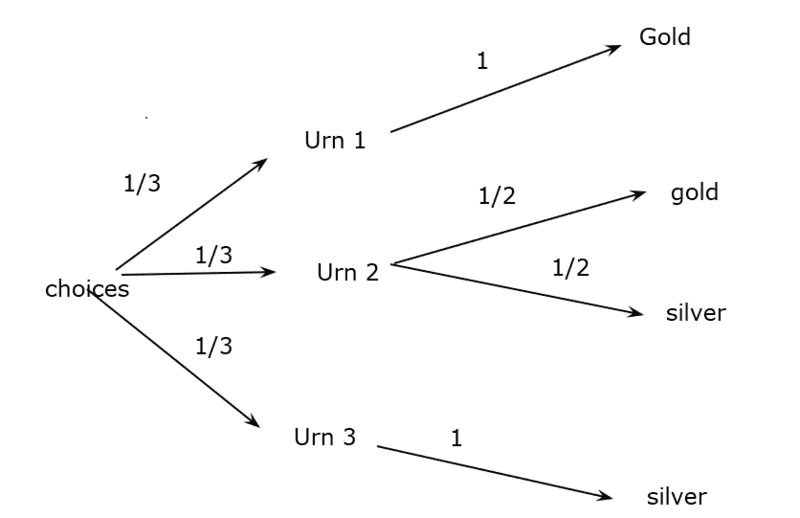

There are three urn contains coins
Urn 1: 5 gold coins
Urn 2: 3 gold, 3 silver
Urn 3: 3 silver
An urn is selected at randonm & a coin is drawn from the urn. If the selected coin is silver, what is the probability that urn III was selected
Determine the probability using Bayes formula & a tree
Bayes Formula
From my understanding of Bayes formula, it should look like something like this
[tex] P(Silver| III) = \frac{P(III | silver) \times P(silver)}{P(III)} [/tex]
now we know that P(urn III) = 1/3
and the probability of P(silver) = Pr(silver|urn I) + P(silver|urn II) + P(silver|urn III) = 1/3 (0) + 1/3 (1/2) + 1/3 (1) = 1/2
But how do i calculate P(urn 3|silver) ? Would it simply be 1/3?
If I used this, then
P(Silver| III) = (1/3)(1/2) / (1/3) = 1/2. is this correct?Using the tree, I have attached what I believe is the right tree.
Would the answer then be P(silver| urn III) = 1/3 / (1/2) = 2/3 ?

It's not clear to me whether you are trying to calculate the probability of urn 3 given silver;or, silver given urn 3.
The probability tree is the way to go, IMO. But you need to combine probabilities as you go along. The last column in the tree should sum to 1, not 2 ( as you have).

stunner5000pt said:
In the tree, doesn't it all add to 1?
it doesn't. The last column adds up to 2.
stunner5000pt said:
That is the
top probability is for urn 1 is 1/3, \
the middle two for urn 2 are 1/6 each and if you add them together you get 1/3,
and the bottom is 1/3
so if we add the 3(1/3) = 1?
Those numbers are missing from your tree.
In any case, how do you interpret your tree?

It is whatever you get when you plug the numbers into the Relevant Equation you gave us.
Rearrange the Relevant Equation to get P(urn III | silver) = P(silver | urn III)P(urn III) / P(silver).
No. P(urn III | silver) = P(silver | urn III)P(urn III) / P(silver) = ???.
Yes,
CORRECTION: I think you mean P(urn III | silver = 2/3. That is what the problem asked for.

FactChecker said:
Yes.
Except ##P(silver| III) =1##, as that is the probability of silver given urn III.
Likes FactChecker and stunner5000pt
Thanks! I stand corrected. I'm sure that he meant P( urn III | silver), which is what the problem asked for. I corrected my post.
