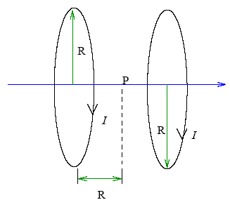

Q3:(see attachments)
A proton is fired along the axis (center) of two circular loops of wire with a speed 2e4 m/s.
The loops carry identical 10A currents, flowing in the same direction;radius R=0.25.
a. What magnetic force (magnitude and direction) does the proton experience at point P ? (set up will be like: loop1-distant R- point P –distant R- loop2)
b. Suppose that proton is fired between the coils into the page. Qualifiedly describe its trajectory as it moves between the coils.
(set up will be like: loop1-distant R- point P (into the page) –distant R- loop2)

a. From The Biot-Savart law, I get [itex]B(P) =\frac { \mu }{ (4 \Pi)} I \int \frac {dl x \hat r}{r^2} [/itex]; B=8.88e(-6)
But because there are 2 same loops, and same distant away from point P, so 2 of them cancel each other out, so there is no magnetic field at point P, so there is no magnetic force.
b. The trajectory of the proton should not change, since both loops’ magnetic field cancel out each other, so there is no magnetic force acting on the proton.
I assume point P is on the axis right in the middle between the two loops.
What makes you think that the magnetic fields from each loop cancel each other?

a.
after thinking through this problem, the magnetic fields should not cancel each other because the current on both loops is going the same direction.
So [tex] B = \frac {\mu I}{2} ( \frac {R^2}{(R^2 + R^2)^(3/2)})[/tex]
And [tex]F_B = \int I (dl x B) = IB [/tex]
So the magnetic force at point P should be [itex]2IB[/itex]. And the direction should be along the center line (bule line in the picture a.) Is that correct?
b.
The trajectory should move toward the right side, since 2 loops have the same magnetic fields pulling the proton.
Much better. That will be the contribution to the field at P due to one of the loops; the net B will be twice that and directed along the axis.
There is no current, just a moving charge. The force on that charge is [itex]F = q \vec{v} \times \vec{B}[/itex]. Since the proton velocity and the magnetic field are parallel, what will be the magnetic force on the proton?
b.
Figure out the direction of the magnetic force on the proton. In this case the proton velocity is perpendicular to the B field.

So for #3a, [itex]F_B = 0[/itex]... Didn't see that coming..
