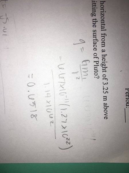

An astronaut throws a rock at 12 m/s at an angle of 25° above horizontal from a height of 3.25 m above the surface. How far horizontally does the rock travel before hitting the surface of Pluto?
Pluto has a mass of 1.27 E22 kg
And a radius of 1.14E6 m
(Projectile equations )
d=vo(t) + .5a(t^2)
Dx=vx (t)
I know how to solve projectiles , except how do I find gravitational acceleration for Pluto ? [/B]

I’m not trying to find mass, the mass is given .
I’m looking for gravitational acceleration,
I keep getting 0.65 but I’m not sure if that’s correct
0.65 what? m/s2?
Please post all your working.
haruspex said:
No, the mass you are given is the mass of the planet.
In post #5 you complained that you are not given the mass of the rock, so you cannot use the formula to find the force on it. I keep trying to explain to you that that is not a problem. You can find an expression for the force which includes the mass of the rock as an unknown.
0.65 what? m/s2?
