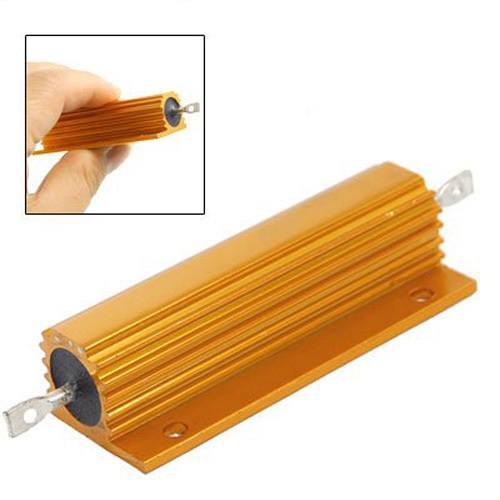

Hi.
I have to test a couple PSUs (ripple, regulation, etc.) that are rated 12 V 62.5 A. In order to do so, I need a test load; I was thinking about using nine 2 ohm 100 W 5% resistors (about 3 usd) in parallel (giving 0.22 ohm 900 w). Taking into account the tolerance of the resistors, I get a total current in between 51.43 A and 56.84 A and, for a single resistor, a maximum dissipated power of 76 W.
For the resistors to be able to dissipate their rated power, they need to be mounted on a heatsink (12" x 12" x 0.125" aluminum sheet it's recommended in the attached datasheet). I would like to use a different type of heatsink (specifically, the ones used on computer's CPUs), but I don't know how to tell if that replacement it's valid.
To summarize, my questions will be:
1.- Is this the best way to test the PSUs?
2.- Is my reasoning right?
3.- How do I determine a different heatsink (the datasheet does not give a thermal resistance)?
Thanks in advance.

You can go roughly by sq inches of surface area. (294 sq. in. surface area per resistor)
There is a graph for the effect of reduced heat sink area. (100W resistor = 75W at 60% area)
You also need to consider the ambient air temperature.
You need to determine the effective surface area of the cpu heatsinks or their thermal resistance to ambient air.
I'm surprised you can't find thermal resistance for them.
The resistors are tested at 250C so 40W at 25C ambient would mean 225/40 = 5.6C/watt for the resistors in free air
100W @ 25C on the plates would mean 225/200 = 1.12C/watt
You will have to research the characteristics of a flat 12x12x0.125 plate to calculate thermal resistance to the plate.

Automobile headlamps make a handy load for such tests at 12 volts, readily available and not too expensive
just be aware they have inrush current when first turned on that's several times their steady state current
so don't switch them on all at once.

I have done this as well. I used sealed beam bulbs with a 2 filaments. They can be wired any combination of ways. Put the 2 filaments in series, parallel or just one at a time and of course separate bulbs can be wired up in different configurations. Once the filament has been warmed by starting it with both of them in series they can be switched to parallel.
Use about 12.5m , 1mm2 varnish insulated copperwire, wind it to at coil and drop it into a bucketful of water ( with ice cubes ).
Then you will have about 0.22Ω, which you are free to adjust by varying the length.
Thanks everyone for replying. I will use automobile headlamps, then.

The PSUs are HP common slot, the ones used in servers.
The tests I was planning on doing where regulation with load (which should be within 5% for atx) and ripple (120 mVpp for atx).
Regarding inrush current (100 ms max?), I couldn't find the time needed for the overcurrent protection to shutdown the PSU. But, if indeed the PSU gets shutdown because inrush current, I could build a current limiter (which seemed easy, although I barely glanced at it).
Thanks for answering!
PS: With "regulation" (I don't know if that's the right name), I mean that the output stays in between 12 V +- 5% under load, in this case.
PS2: Another test could be to check if the over temperature protection (if it exists) doesn't shuts down the PSUs after a certain time.
Hmmm... I didn't know headlamps plus a 60Amp current limiter had gotten cheaper than the resistors (3usd each in the OP). Guess I'll have to check that out for my next project.
