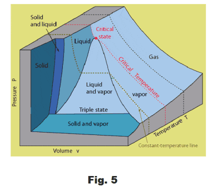

The water doesn't start to evaporate at 100 °C, but earlier. Have you ever heard of Dalton's law? It says that the total air pressure is the sum of all the partial pressures of its components - the partial pressures corrispond to the volume and molucule fraction of the different gases. That means, that 1 bar of air pressure is roughly the sum of 0.79 bar "nitrogen-pressure" an 0.21 bar "oxygen-pressure". However there are more components than these two in the air, also steam. Depending on its temperature, water has a certain vapor pressure, which is the maximal possible (partial) pressure of water in gaseous phase. At 100 °C the vapor pressure is 1 bar, therefore all the water can evaporate. The vapor pressure of water at 20°C is 0,0234 bar. That means if the water has a temperature of 20°C and the pressure is 1 bar, water can evaporate till 2.34 % of the air consists out of steam.
Find attached a diagram of the temperatur vs. pressure for water to find the boiling temperature depending on the pressure or the vapor pressure depending on the temperature
PS.: The ratio of the actual partial pressure (volume/molecule fraction) steam in the air to the maximal possible (=the vapor pressure dependent on the temperature) is called the relative humidity.
