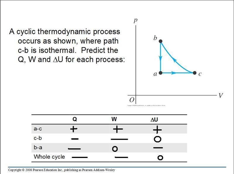

Can some one check my work, I'm not sure if I am understanding how internal energy heat and work are related.
Work is defined to be positive if the system does work on the environment.
Q=[itex]\Delta U[/itex] +W
I am showing if the process is positive, negative or 0.
Also this is suppose to be an ideal gas

Your answers are correct. What kind of a cycle is it?
