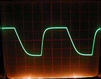

uart and baluncore's observations are spot on.
The 'scope told him something and we don't know what.
That would've been the time to ask him to point what it was about the 'scope trace telling him that..
Here's a trace that's in need of some help "pulling down", observe the down transition is slooo-ww, and the up transition is no Barney Oldfield.. .
Most senior guys appreciate honest questions.
thank you baluncore, uart and Jim Hardy.
Mr. Hardy, the pics really helped! I can't say I completely understand but definitely get some of it. Maybe I should consider taking a more indepth electronics course.
