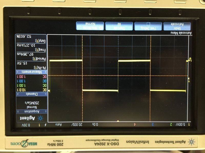

i have set up the circuit, but i do have some problem that i can't figure it out..
  • my frequency requirement is 20khz, i do follow the formula that the data sheet given, base on my oscilloscope, it shown 10khz.. capacitor voltage is 0.01 micro. resistor value is 5.5k ohms.
  • when i connect the the potentiometer, i can't adjust the duty cycle at all..
I have attach
  • my circuit output oscilloscope result.
  • circuit that i set up

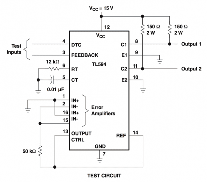

  • and datasheet, it content the formula that i use..
data sheet for TL594
please give me some advice on this..

I just got you a schematic that works. Start with that and experiment with component values.
so the output will be pwm signal and i able to adjust the duty cycle?
Try!

First, build everything to the left - No MOSFETS / transformer...
Spend time with the resulting circuit until you are satisfied it's working. Then, add the MOSFETS with transformer, but no output rectifiers. Be careful as you explore this configuration as the mosfets are likely to be damaged by small errors.
For the transformer, I would look up coiltronic's VersaPak. These are designed to help beginners get working power supplies and have support documents.
With the transformer, but no rectifiers, study the voltage waveforms on the drain of each MOSFET. You will see voltage spikes when each MOSFET is turned off. Adding a resistive load to the output of the transformer, you'll see these spikes become worse. What you're seeing is the energy stored in the leakage inductance of the transformer. Search under the word snubber to find circuits that can absorb the energy so that it doesn't harm your mosfets.
Next, add your rectifiers. There are issues with rectifiers in that they don't turn off immediately and this will cause ringing and voltage spikes. Again, snubbers across your rectifiers will help. Also, experiment with the rectifiers. Different ones behave radically different.
Spend time, pace yourself, and this circuit can bring a great deal of wisdom :-)
