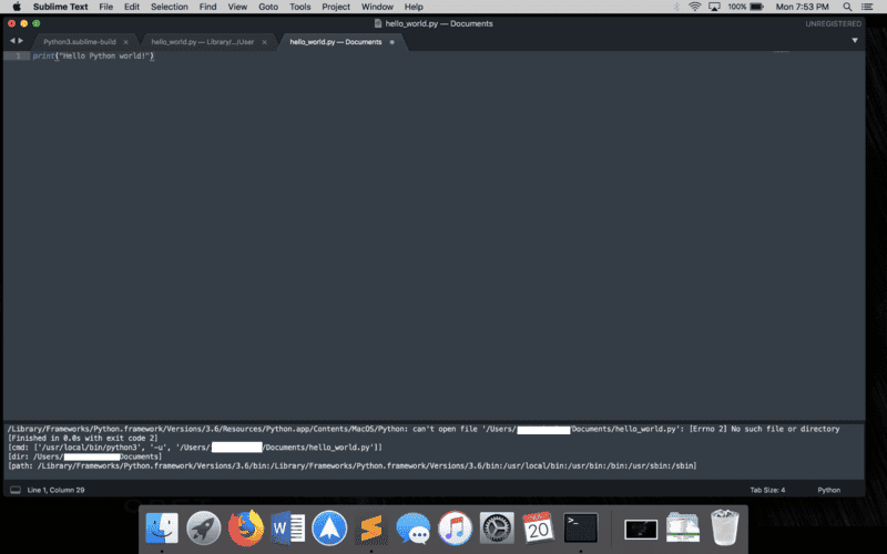

Hi guys. Just wanted to see if I could get a point on this problem I'm having.
I'm using a book to learn Python3 and I'm using SublimeText as an editor.
The book initially told me to configure Sublime for Python3 by typing this into a blank Sublime file:
"cmd": ["/usr/local/bin/python3", "-u", "$file"],
and to save it wherever it prompted me to (which was User file)
Now the book tells me to File > Save as as document called hello_world.py in a particular folder that I made.
However, when I try to save it to this location in Sublime, it doesn't give me this option. So in Sublime, I save it to Documents. Then I went into Documents and dragged it into the folder that I made.
It then tells me to type this snippet command into Sublime and I should get something out of it. But as you can see in the screenshot, I just get an error. I cropped out my name where it occurred in the error for privacy reasons.
Can someone tell me how to save the file in Sublime into the folder that I created so that I can get this to work?

A copy and paste of the code to make it easier to see:
/Library/Frameworks/Python.framework/Versions/3.6/Resources/Python.app/Contents/MacOS/Python: can't open file '/Users/NAME/Documents/hello_world.py': [Errno 2] No such file or directory
[Finished in 0.0s with exit code 2]
[cmd: ['/usr/local/bin/python3', '-u', '/Users/NAME/Documents/hello_world.py']]
[dir: /Users/NAME/Documents]
[path: /Library/Frameworks/Python.framework/Versions/3.6/bin:/Library/Frameworks/Python.framework/Versions/3.6/bin:/usr/local/bin:/usr/bin:/bin:/usr/sbin:/sbin]

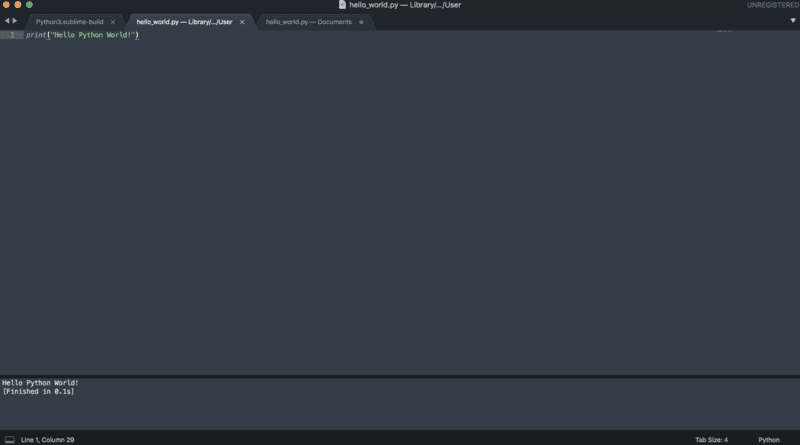

Also, when it's going through the User file, the snippet program will work, as seen in this screenshot. But on the last tab, it just says it's in Documents, and not the folder than I dragged it into.
