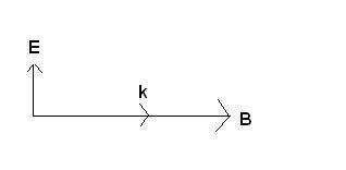

I am looking at a bunch of atoms in a homogeneous magnetic field, irridiated by a monochromatic EM wave. I am trying to figure out how to intensity pattern of the emitted light by the atoms looks.
Case 1) I have attached a picture of the situation called "case_1.jpg". It is very clear that only π-transitions are being driven, i.e. Δm=0 transitions.

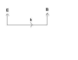

Case 2) I have attached a picture of the situation again. The quantization axis points along the magnetic field, but the polarization is orthogonal to it. So somehow I need to decompose the polarization into something in the same plane as the B-field. How can I do that?

Ah, ok. I think I figured it out entirely by myself. I can of course always decompose it into circularly polarized light along k. So they will drive the Δm=+1 and Δm=-1 transition. But then what happens when B is perpendicular to both k and E? Then my "trick" doesn't work anymore.

I'm pretty sure having E perp. to k perp. to B will still yield a signal. I just don't see how I can ever decompose E into something along B, but I know it is possible.
You can still decompose the linear polarization into two circular ones. What changes wrt case_1 is the relative phase between the two circular waves.
Therefore you should get the same spectrum as in case_1, i.e. delta-m=0.
Hi
Thanks for replying! However I have to disagree. So B is perp. to k, which is perp. to E: If the electron is oscillating circularly along B, then looking "edge on", it looks linear. And it is exactly this motion that the E-field excites. So the transitions being driven are delta-m = +/- 1.
Does this sound reasonable to you?
When I find a moment I will work this out in detail.
You can write the dipole operator ε.r as Ʃ_m |r| ε_m Y_1,m
where m=-1,0,1 and Y_1,m is a spherical harmonic.
The matrix element then reduces to an amplitude prefactor and some
Clebsch-Gordans. If you know the initial and final angular momenta
this is easy to write down exactly.
