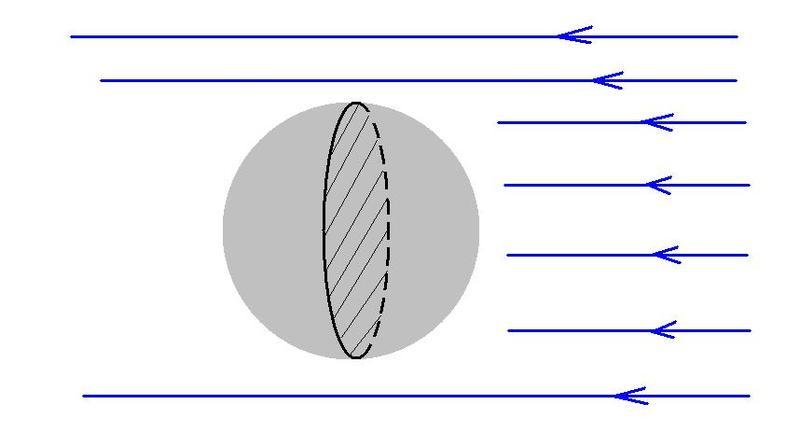

Why can we assume to effective area to receive energy is pi r^2? The total surface area is 4 pi r^2.. so why would it be a quarter of this value? What if the light beam was much wider than the atom - surely the max effective area would be 2pi r^2?

Light beam, as I understand, is a straight beam propagating in only one direction (see the 1st picture). Laser is an example.
Then have a look at this: http://en.wikipedia.org/wiki/Flux and this: http://en.wikipedia.org/wiki/Poynting_flux

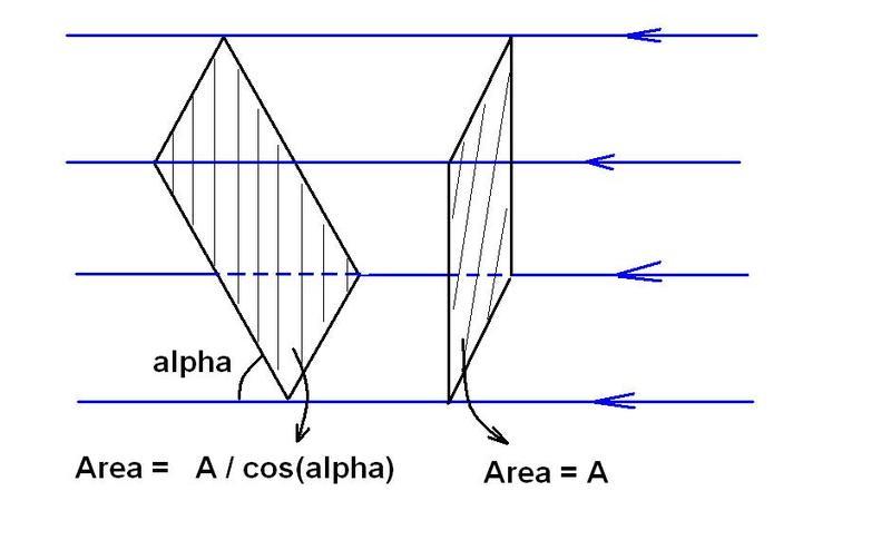

Although those are not relevant, they may help you understand how the sphere receives the energy. Anyway, look at the 2nd picture. There are 2 surfaces "catching" the flow of energy (or energy flux, or energy per unit area). Intuitively we can see that they catch the same amount of flux, though their areas are different. So however slanted the surface is, the real effective area is only the one that faces directly and perpendicularly to the flow. In the case of a sphere, that's surely be pi*r^2.

I understand now that the effective area is only the one that faces perpendicularly to the flow. I'm just curious as to what the working would be to show that this is pi r^2?
Thank you again.
its just the area of a circle of radius equal to the spheres radius

Yeh I realized that - I just wasn't sure as to the derivation of why that is the area perp. to the beam..I know this one is quite easy to see just by visualising it, but want to learn the method for more complicated examples...

Hehe, I'm not good at math, so I don't know if there is a general method. You can find the area of the projection of the whole surface/thing onto a plane which is perpendicular to the propagation direction of the light beam.
In the case of a sphere, regardless of direction, the projection of the sphere onto ANY plane is a circle of the same radius.
Hope that helps :smile:
