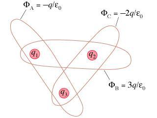

Question 4
What is the charge q_1?
What is the charge q_2?
What is the charge q_3?
Unsure of which equation to use, and the equations that I am looking at involve integration.
Φ = integral (E * dA) = EA sphere
Φ = q / ε
Can someone teach me how to do this problem?

HINT:Use the property of the electric flux (which is a scalar) of adding wrt the same surface.You'll have to solve a very simple system of equations...

Property of Electric Flux = EA cos theta? But there is no theta. Unsure of the area and of the E.
No.Let be [itex] \Phi_{1} [/itex] the electric flux generated by a charge [itex] q_{1} [/itex] through the (closed) surface S.Similar [itex] \Phi_{2} [/itex] for q_{2} [/itex].Then the total flux is simply the sum of Phi's which,due to the same denominator (epsilon),translates to the charges...

So what is the charge of q_1, q_2, and q_3?
-q/E + (-2q/E) + 3q/E = 0/E = 0
The charge of each is 0?
No,you have to write equations of the type phi_{1}+phi_{2}=phi_{tot} for all 3 surfaces & will end up with an algebraic system of 3 eqn. with 3 unknowns,namely the charges.

Okay, got it. The answers are 2q, q, -3q. Am I correct?
