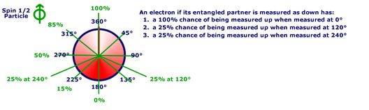

I wonder if everyone agrees with these statements, (flipping one spin for the moment as in photons to keep it simple). I choose the words "not measurable" carefully, but would be open to suggestions or changes. TIA:
At 0° - 100% measured up, 0% down, 0% not measurable
At 22.5° - 85% measured up, 0% down, 15% not measurable
At 45° - 50% measured up, 0% down, 50% not measurable
At 67.5° - 15% measured up, 0% down, 85% not measurable
At 90° - 0% measured up, 0% down, 100% not measurable
At 112.5° - 0% measured up, 15% down, 85% not measurable
At 135° - 0% measured up, 50% down, 50% not measurable
At 180° - 0% measured up, 100% down, 0% not measurable
and specifically:
At 120° - 0% measured up, 25% down, 75% not measurable
At 240° - 0% measured up, 25% down, 75% not measurable

What do you mean by "agree"? Are you asking whether your statements would actually be predicted by QM (in which case no, QM does not predict any reason that there must necessarily be a fraction that are "not measurable" beyond just inefficiencies in the design of your detector, which could always be improved upon), or are you asking whether we agree that there could be a self-consistent model where the above is true, or something else?
"agree" would mean both I guess, what do you think QM predicts and do you think it is correct.
I am guessing that you "agree" (both meanings) with the first 2 columns (probability of up and probability of down) but do not agree on the last column, but I am not sure, hence the question?

They are 100% measurable in the ideal case. Just use a beam splitter, you see almost 100% at any angle.

No, in QM with an ideally efficient detector, probability of up and probability of down should always add up to 1. Also, can we assume you are talking about photons that have already passed through a previous polarizer at angle 0°, or a photon that's a member of an entangled pair where the other member was found to pass through a polarizer at angle 0°? If not I don't understand why you would say there's a 100% chance of passing through at 0° (and this is assuming that by "up" you mean it passes through a polarizer at that angle, while by "down" you mean it's reflected...normally "up" and "down" are used when referring to spin measurements on particles like electrons)

The OP asked the probability of an up and a probability of a down. From this post, I assume you think there is a 50% chance he will measure opposite results (Ie. a "down" as he has worded it). I assumed from the calculation that you have used, that the probability of the same results for this seup is 0% (Ie. a "up" as he has worded the experiment). Just wondering if I am reading you correctly?

The OP asked how many up and how many down. Do you agree with Jesse (as I do) that you would measure 50% down (as he has worded the experiment)? What do you feel the percentage of "ups" would be measured as he has worded the experiment?
No, down does not refer to "opposite results", it's a specific result at one detector. If you have two detectors A and B, then "opposite results" would mean either A gets up and B gets down, or A gets down and B gets up (likewise "same results" would mean either they both get up or they both get down). And the OP was talking about spin of an electron and a positron (as measured by something like a Stern Gerlach magnet), not about photons passing through polarizers.
Anyway, the idea here would be that if B measured the positron to be spin-down at b degrees, then if A uses angle a, the probability that A will measure the electron to be spin-up at a degrees would be cos^2[(a-b)/2]. And that means that in the same scenario, the probability that A will get the result spin-down would be 1 - cos^2[(a-b)/2] = sin^2[(a-b)/2].
If you prefer to think about experiments with photon polarization, in this case I believe you won't have that factor of 1/2 inside the cos^2 (though I'm not sure if this is true for all types of entangled photon polarization experiments or just some). Then if B measured the photon to pass through a polarizer at b degrees, and A uses angle a for his polarizer, the probability the photon will pass through A's polarizer is cos^2[a-b]. This means that the probability the photon is reflected by A's polarizer is 1 - cos^2[a-b] = sin^2[a-b].
Sorry, you are losing me. You calculated 50% for "down", what do you feel the percentage of "ups" would be measured as he has worded the experiment? 0%, 10%, 20%, 50%?

My calculation there was slightly inaccurate because I didn't include the (1/2) factor in the cos^2--when measuring an electron spin it would actually be at 90 degrees (not 45 as I said originally) that you'd have a 50% chance of "down" when the other particle was measured "up" at 0 degrees. Anyway, as I said before the probabilities always add up to 1, so naturally in this example there would be a 50% chance of "up".
So you don't think its 50% at 45 degrees?
For photon polarization I think it would be, but not for electron spin. That's what I was saying in the last paragraph of post #25.

What do you think it is for the OP?
  • #31
The OP said it was about spin of an electron/positron pair, so as I said in post #25, 50% at 90 degrees, not at 45 degrees (at 45 it should be 88.85355339% that one electron is spin-up if the positron was spin-down at 0 degrees)

No problem, the difference between particles (photons/electrons) and ways of measuring (beam splitters/filters) can certainly cause confusion. Just to double check the 88.85%, as I get 85.35% using the cos^2 with the 1/2? What did you use to get 88.85% or did I do it different then you?
  • #33
You're right, I messed up when copying and pasting, I got that the answer was 0.85355339 but then somehow I thought I had just copied the part after the first two digits rather than the whole thing, so I thought I needed to type the first two digits and I misremembered them as "88". Anyway, it should be 85.355339%.

In all cases, assuming either a mixed or entangled state, you see 50% up and 50% down. The only points I am making really are:
a) that Alice and Bob see only random patterns until they correlate their results (done at light speed or less, of course).
b) other than signal losses due to a less than ideal setup, there is nothing tangible about some particles being somehow detectable and others not. They are all detected. If they cannot be matched later (into a pair, one Alice and one Bob), that is simply an indication they were not entangled.

I think edguy99 is talking about the conditional probability that we will see "up" at one detector at angle a, given that we have already observed "down" with the entangled particle at another detector at angle b. In this case I think you would agree the probability of "up" is cos^2[(a-b)/2]
