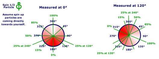

Yes, and I hope to extend it to other angles. Would you agree with these figures:
At 0° - 100% measured up, 0% down
At 45° - 85% measured up, 15% down
At 90° - 50% measured up, 50% down
At 135° - 15% measured up, 85% down
At 180° - 0% measured up, 100% down
At 225° - 15% measured up, 85% down
At 270° - 50% measured up, 50% down
At 360° - 100% measured up, 0% down
and specifically:
At 120° - 25% measured up, 75% down
At 240° - 25% measured up, 75% down
and specifically:
Yes, I agree with all of these for an electron.

  • #45
I have applied these probabilities to the picture below:
and a "mini bell test" with Case A=0 degrees B=120 degrees C=240
[1] A+ B+ C+ 1.00*0.25*0.25 = .0625
[2] A+ B+ C- 1.00*0.25*0.75 = .1875
[3] A+ B- C+ 1.00*0.75*0.25 = .1875
[4] A+ B- C- 1.00*0.75*0.75 = .5625
Assume we know the measurement at A will be "up" since we know its entangled particle is "down". This chart would give the probability of measuring the configuration specified, certainly the most common is that you measure "down" at B and C.
  • #46

  • #47
I don't get it, why are you multiplying the three probabilities? What is the final probability at the end of each line supposed to be? Are you imagining we look at three successive measurements of different particles at angles A,B,C (and only on trials where the other particle was measured "down"), so for example [1] would calculate the probability that our first measurement at angle A would get "up" and the second measurement at angle B would get "up" and the third measurement at angle C would get "up"? If not, can you explain the physical meaning of the probability at the end of each line?

  • #49

I have re-drawn the picture to reflect that the observer of the positron starts to measure at B=120 degrees. Notice how 75% of the former "ups" are now measuring "down" and 25% still show "up"
So I would disagree with the statement:
"Then if the positron gives "down" at angle B we know the electron's hidden state must be one that has a B+"
In this simulation, the B+ is only 75% sure. The other 25% of the time, it is B-.
  • #60
