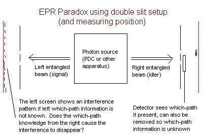

(OK, this probably makes no sense whatsoever, but...)
The EPR Paradox applies to any quantum properties which are measured on one particle of an entangled pair. That should apply to a position measurement as well. If you learn something about the position of one particle, say the Right, haven't learned something about the position of the one on the Left?
In our attached figure, one photon goes Left and the other Right. We measure the path/position of the photon on the Right by means of a detector. That leads to a loss of interference per the standard Double Slit experiment, and no interference is seen on the Right screen. We now know the which-path information of the Left photon as well. Should that affect what we see on the Left screen, so that its expected interference pattern is also erased?
-DrChinese

Please... will someone (other than Caroline) please comment on my post #18 above (go up 6 posts)!
I have an attached diagram you should be able to view in your browser. It is using the EPR paradox setup with double slits. Your comments are appreciated!
-DrChinese
Ok,I'll have a go. I'll throw some ugly standard quantum mechanics onto it.
I guess that the correlation between the photons is, that if the left photon goes up, then the right goes down, and vice versa. If it is the opposite, swap the sense of "up" on the right side :smile:.
So your initial state is:
|psi0> = 1/sqrt(2) ( |+>|-> + f |-> |+>)
Here, the first state in the tensor product is the left photon, and the second state is the right photon. + means up and - means down (in position, here).
f is the phase factor between the two possibilities, taking into account path lengths ; usually this will be a fixed factor and we can take f = 1.
The image on the left is found by looking at each position along the left screen, and the corresponding left eigenvector (left photon seen) is |x> = |+> + g |->. The eigenvector (photon not seen) is the orthogonal one: |~x> = -g*|+> + |-> (up to sqrt(2))
g is a rotating phase factor along the image.
Inverting: |+> = |x> - g* |~x>
|-> = g |x> + |~x>
writing psi0 in the detector basis:
|psi0> = 1/2 ( (|x> - g* |~x>)|->
+ ( g |x> + |~x>) |+> )
The case of a detector at the low right end gives us a picture on the left (coincidence with detector)
<x|<-| psi0> = 1/2, so the probability is 1/4
This is independent of g, so no interference in the correlation.
The case of a detector at the upper right gives us
<x|<+| psi0> = 1/2 g*, so probability also 1/4
The full density matrix is given by |psi><psi| If you then trace out the second basis (the |+> and the |->) you get the (left) local density matrix, which comes down to a 1/2 - 1/2 mixture of |x> and |~x>. So also no interference.
full matrix:
1/4 g*/4 g*/4 - g*^2/4
g/4 1/4 1/4 -g*/
g/4 1/4 1/4 - g*/4
-g^2/4 -g/4 -g/4 1/4
local matrix (traces of the 4 (2x2) blocks)
1/2 0
0 1/2
We NEVER see any interference on the left, with or without detector on the right, with or without coincidence.

Hi patrick! I am suprised, because I think we should always see an interference pattern on the left screen if we assume that the size of the slits allow them (in accordance with the wavelenght of the light beam). However, I am not sure that I have well understood Dr Chinese experiment thought and all your demonstration.
So I will add my own interpretation (do not hesitate to correct me if I am wrong):
We do not need to detail very much the right slits + detector: It is, in fact, a particular measurement apparatus (i.e. we may consider the right slits+detector as a right measurement apparatus with given measurement results):
The “right detector+slits” will give results, which we model with a set of coarse states:
** for a received right photon |+> before the right slits, we have the result |detector+>
** for a received right photon |-> before the right slits, we have the result |detector->
I agree we can detail the slits interaction + detector result (we may increase the number of Hilbert spaces, but it will not change this “macroscopic” behaviour, i.e. we can describe the diffraction of the photons and thereafter the detection on a given location on the right part, but it is not really important for the result on the left beam, as we have local interactions for the measurements).
Thus, if we accept this basic approach, we can model the right measurement apparatus by the following "projector":
P_right= |R:+><R:+||detector+><RIDS|+
|R:-><R:-||detector-><RIDS|
Where RIDS means “right initial detector state” (in order to avoid extra complications)
So, if we take your initial state outputted by the PDC source and the initial right detector state together with the initial left screen state, we have (removing the normalisation coefficients and imperfections):
|psi0> = (|L:+>|R:-> + |L:-> |R:+>)(x)|RIDS>(x)|LISS>
( |LISS> is the left initial screen state)
After the interaction with the right measurement apparatus, we have:
|psi>=P_right.|psi0>=|L:+>|R:->|detector->|LISS>+|L:->|R:+>|detector+>|LISS>
And if we model the left slit interference pattern on the left screen, we have (it is also a measurement):
** for a received |L:+> left photon state, the interaction of the left slits product the state |interference+> (the interference pattern of spin + photons on the left screen)
** for a received |L:-> left photon state, the interaction of the left slits product the state |interference-> (the interference pattern of spin - photons on the left screen)
i.e. we can model the left screen interference result by a "projector":
P_left=|L:+><L:+||Interference+><LISS|+
|L:-><L:-||Interference-><LISS|
Where LISS means “Left initial screen state”.
We have [P_left,P_right]=0 by construction (they act on different Hilbert spaces) that means that we can do the measurements in what order we want (left screen before the right detector or the inverse, separated by a space like interval or not, etc ...): we still have the final state:
|psi_end>= P_left|psi>=P_left.P_right.|psi0>= P_right.P_left.|psi0>=
|L:+>|R:->|detector->|interference+>+|L:->|R:+>|detector+>| interference->
This global state shows that we always have an interference pattern whatever the results on the right side are: the left screen always receives the diffraction pattern of the left photons of spin + and – whatever measurements are done on the right side of the beam.
However, I may have missed something in this discussion. So sorry, If I am out of scope.
Seratend.

You are completely right, but your conclusion that this state gives rise to an interference pattern is wrong: we are not home yet.
The problem is that you still have the R states in your expression. You should instead calculate the expectation value for a specific left operator, say the one that looks at |in a> = (|interference+> + f |interference->) which is the amplitude on the screen at a specific spot (another spot has another phase factor f).
Note that I am not very fond of the name "interference+" because a pure interference+ state gives NO interference, I hope you agree with that ; it is only when we get superpositions of interference+ and interference- that we get an interference pattern.
So we should calculate:
<psi_end | in a> <in a| psi_end>
to find the intensity at a specific spot on the left screen (determined by the phase factor f)
<in_a|psi_end> = (<interference+| + f* <interference-|)|L:+>|R:->|detector->|interference+>+|L:->|R:+>|detector+>| interference->
= |L:+>|R:->|detector-> + f*|L:->|R:+>|detector+>
and multiply this with its conjugate, to find:
1 + f f* = 2
As f is a phase factor.
We find 2 (we should find 1/2, but left out all normalizations).
Note that this is INDEPENDENT of f, and hence there is no interference pattern.
You see also why: it is the orthogonality of the entangled states (R- and R+) which makes that you will never get a dependence on f.
cheers,
Patrick.
PS:
there's a trick to DO FIND an inteference pattern at the left side: that is: put your right side detector not at one of the slits, but put it on the right screen, looking at a specific spot. If you then look at the coincidence hits, you WILL find an inteference pattern on the left side, in that correlated subsample.

Awesome, folks! Finally some actual QM to discuss...
Vanesch,
It is interesting that you picture an interference pattern at the left after moving the detector. But as I understand what you say, the interference appears onky when you compare results from one side to the other. The interference I hoped we would see would be the ordinary kind you would see in a double slit setup... an actual set of bars and white spaces corresponding to peaks and troughs.
seratend,
My intention for the left side was as you pictured it, a double slit suitable for forming an interference pattern. I, too, was imagining that the interefernce pattern would always appear, and wondered if a measurement on the right side could destroy the interference pattern and reduce it to 2 solid bars.
My apologies if my example is not clear. But I think both of you have a good grasp of the setup, or at least what my intention was.
I plan to study Vanesch and seratend's posts more closely. Additional comments are most welcome!
-DrC
Yes, you would expect classically an interference pattern. But the light coming out from a PDC xtal is not classical, because it are 2-photon states.
The reason why you don't see an interference pattern to the left (no matter what happens to the right) is that what is supposed to interfere, namely the photon state "left+" and the photon state "right+" are entangled with something else (in this case, the photon on the right).
And if you work out the expectation value of a local operator on the left, the interference terms that normally would appear if they were not entangled, are put to zero by the inproducts of the states of the entangled photons (which are orthogonal to each other), because the local operator doesn't affect them.
Let us look more explicitly at the algebra:
If you have a state (|+> + |->) |S> (a non-entangled state), and you take the expectation of a local operator (acting only on the left photon), say, O, you have as expectation value for O:
<S| (<+|+<-|) O (|+>+|->) |S> = <S|S> ((O++) + (O--) + (O+-) + (O-+))
(where Oab is a shorthand for <a|O|b> )
So you DO get interference terms O(+-) and O(-+). (<S|S> = 1)
However, if you have an entangled state (|+>|s1> + |->|s2>) (with s1 and s2 orthogonal states of the "other" system), then, the expectation value for O is:
<s1|s1> O(++) + <s1|s2> O(+-) + <s2|s1> O(-+) + <s2|s2> O(++)
= O(++) + O(--) and the interference terms are put to zero by the orthogonality of s1 and s2.
What I did here in algebraic detail is part of the formalism of density matrices.
As an explicit example of O, I will write out O(x) with x a position along the screen on the left (and x in units of fringe phase). In that case,
O(x) takes on the form:
O(x) = |x><x| where |x> is the eigenvector corresponding to maximum intensity at x. It takes on the form:
|x> = |+> + exp(i x) |->
This means that O(x) takes on the form:
O(x) = |+><+| + |-><-| + exp(ix) |-><+| + exp(-ix) |+><-|
So O(x++) = 1
O(x--) = 1
O(x+-) = exp(-ix)
O(x-+) = exp(i x)
you see that you need the cross terms in order to have an x-dependent expectation value (which is nothing else but an interference pattern).
cheers,
Patrick.
